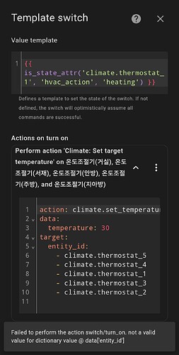

I have been trying to create and test a switch template using UI but have an issue.
I can turn on/off the template manually, but it does not pass on/off testing.
Also system log shows warning every minute if I use the switch template in thermostat.
Can anyone help? Thanks!

I made this on the UI so that indent were automatically put by the system. I checked and they are okay. I’m not sure what the error is: "not a valid value for dictionary value @data[‘entity_id’]

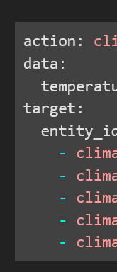

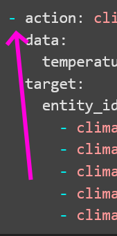

Try putting the actions in as a list. e.g.
- action: climate.set_temperature
    temperature: 30
    entity_id:
      - climate.thermostat_5
      - climate.thermostat_4
      - climate.thermostat_1
      - climate.thermostat_3
      - climate.thermostat_2
I have tried before and that kind of manual test all worked well… Actually, at the beginning I also created this switch in configurations.yaml and it didnt work too. :frowning:
Im sorry tom, but I cannot see any difference between your code and mine. Actions as a list how?
Look closer.
Screenshot 2025-01-15 at 14-34-28 Cannot get a switch template working - Configuration - Home Assistant Community Screenshot 2025-01-15 at 14-34-54 Cannot get a switch template working - Configuration - Home Assistant Community

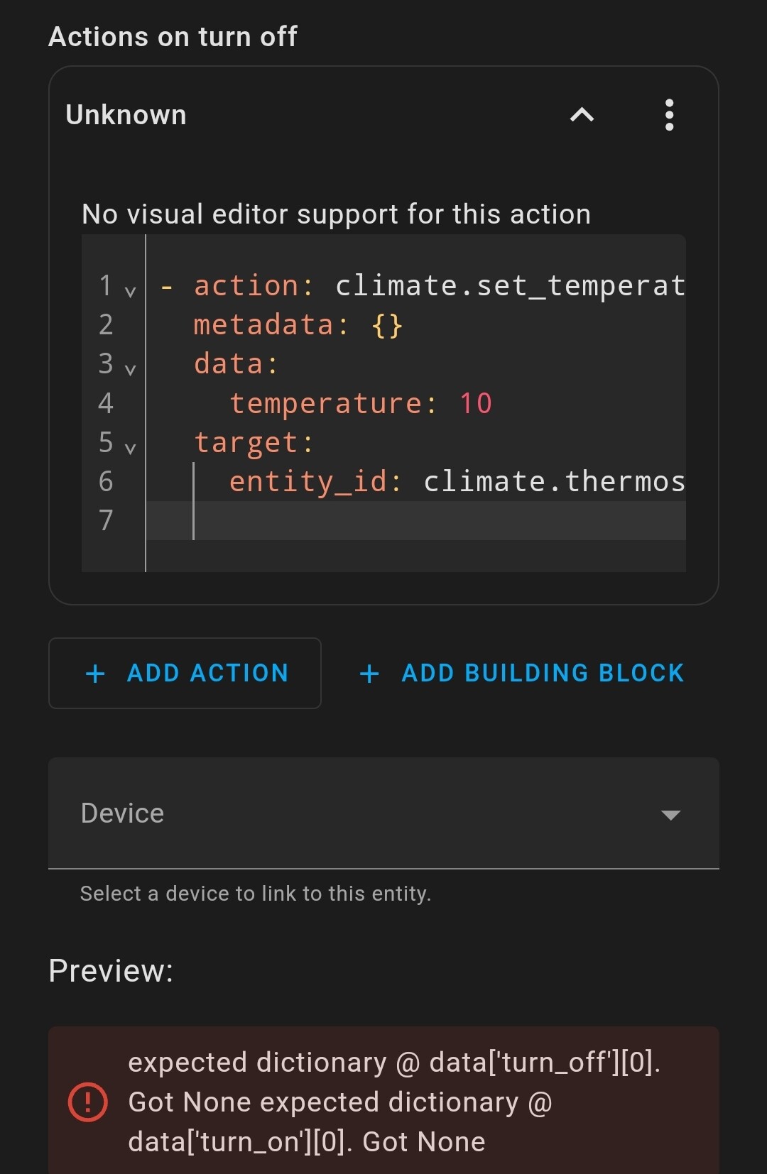

I got it, but after I modified the code entity is not recognized and I got another error…
Ok you cant do that. Go back to what you had. I missed the “Add Action” button below. The helper builds the list for you if you have more than one action.

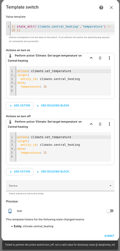

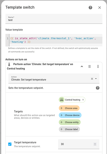

What does it look like in the visual editor? My attempt:

Can you pass on/off testing by touch the toggle button at the bottom? (name would be ‘test’)
Interestingly no, I also get that error:
However, the switch works, changing the temperature between 15 and 16 in my example, without generating any errors in the logs.
