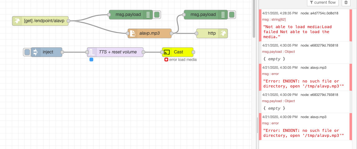

I have a flow in node red where I wanted to play a mp3 file from my local server (where home assistant and node red both are running) to a chromecast device . When I deploy this flow in node red and try to get to this endpoint @ 192.168.XX.XX:1880/endpoint/alavp ,I get this error:
The file exists in the /tmp directory and permissions are changed to 777 . Are there any steps where I need to grant acced to node-red user. If so, what would be the user thatâs running node red

Thanks for the response. After placing the file in /share , I was able to play the file from browser @ http://192.168.XX.XX:1880/endpoint/alavp. However the cast node is unable to play . Still getting this error
"Not able to load media:Load failed Not able to load the media."

Gotcha ok so looks like what youâre trying to should work. Except
If you have credentials configured then that means the endpoint /endpoint/alavp requires basic authentication. Since the cast node does not ask you to provide authentication details for the URL you gave it I have to assume that it only allows URLS which do not require authentication. So I think you would need to remove authentication from your node RED config by setting the http_node option as follows:
http_node:
username: ''
password: ''
The alternative I was suggesting is that HA comes with a special folder in the config directory that it auto-exposes. Like I said above, any file you put in /config/www can be accessed via <HA Base URL>/local/<file name>. So its effectively a shortcut to the HTTP In node thing, just by putting a file in the www folder gives you a URL directly to that file.
Thank you , Yes , the authentication was the problem,It works when I remove the credentials .
