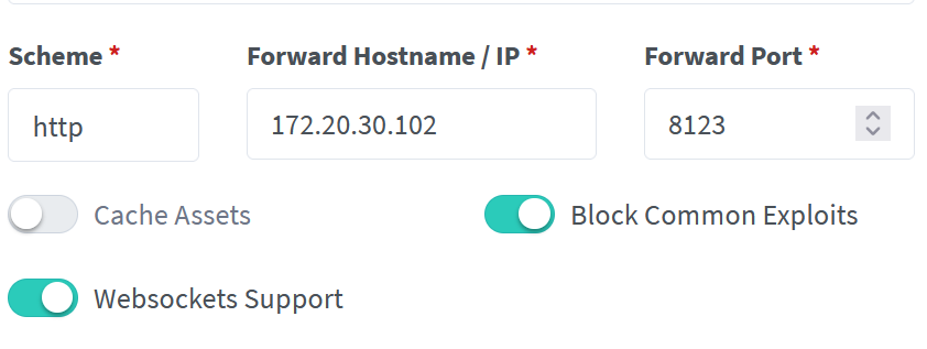

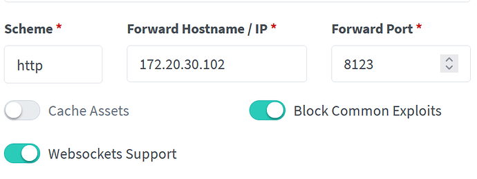

Should this help anyone, this was the fix for me (Using Nginx proxy manager)
Needed to enable “Websockets Support”
