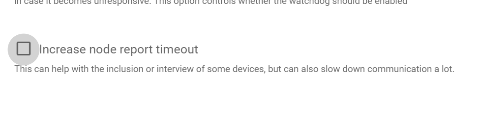

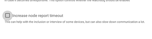

I’m trying to migrate my locks from Smarthings to my new ZWA-2 but cannot get the lock to actually successfully pair. It always ends up with the X on the lock rather than the green checkbox. In these cases in home assistant the only option is Ping and viewing g the firmware version.
Ive attempted to pair with many different procedures but always get the same result. I’ve captured the logs with the most recent attempt.
Here’s the procedure that I followed the last time
  1. Unpaired the device from Smartthings
  2. Removed the lock from the door and placed it on the same shelf that my ZWA-2 antenna is sitting on, kept about 5cm away from it
  3. Factory reset the lock

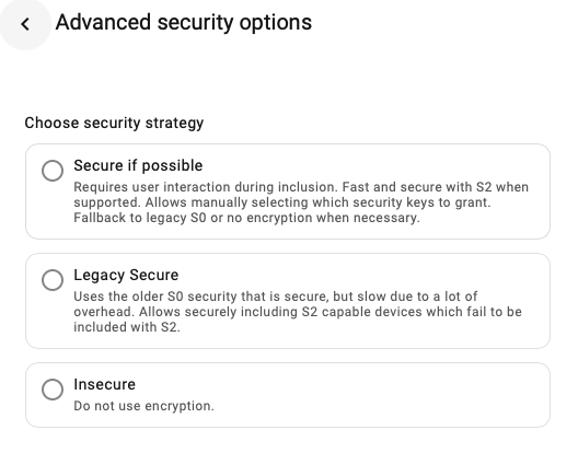

  4. Immediately start the pairing procedure in HA, choose the advance security option security options, choose Legacy Secure since the device is older. (Note these radio buttons don’t seem to stick they always fade out to no option)
    5 Put the lock into pairing mode.
    Home assistant finds the lock but doesn’t it doesn’t have lock functions, the lock itself eventually fails out with the red x. I’ve attempted pairing nearly 20 times without success.
I’ve turned on debug logging for the pairing process and these are the logs from the inclusion process

The main things I see that may be goofing this up could be the failure of the radio button for the choose security strategy to work or this log message

Becasue these older locks take a long time to enumerate all their Command Classes upon inclusion, there’s one missing step…
Exclude the lock, reset it, etc, etc.
Before you start inclusion, you need to turn on “Increase node report timeout” in the ZwaveJS settings:
Then start the inclusion, and wait at least a minute or two (yes, it takes that long). If it doesn’t add correctly, start the process again. make sure you have fresh batteries in the lock and it’s near the controller.
Once it’s added correctly, turn off the setting noted above.

I’ll check the country as well as increase the time out.

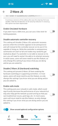

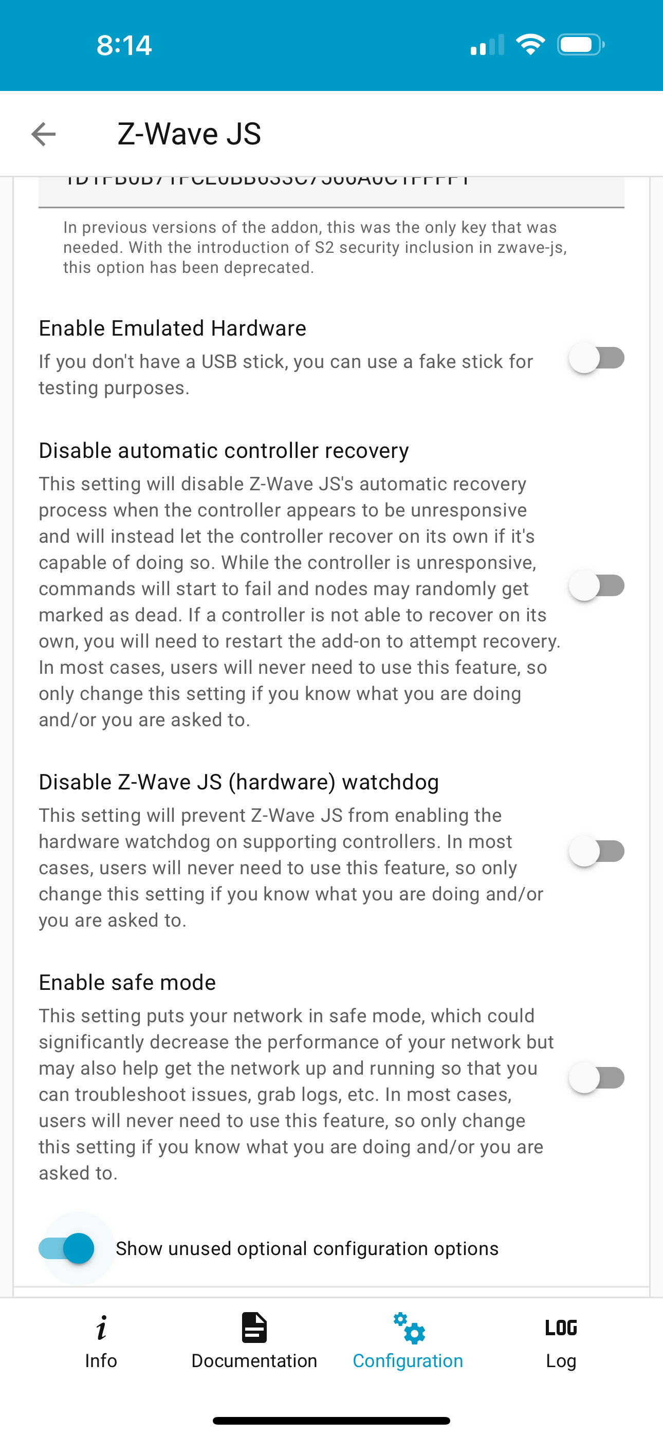

I actually don’t see this setting on v 0.21.0
Is there a setting that I can add to the yaml configuration to facilitate this.
I have no idea since I run Zwave-JS-UI independent of HA. Should be under Config → Zwave
When was the last time you updated the ZwaveJS driver??
Maybe I’ll switch to the zwavejs UI version instead of the standard one. Thank you!

@JohnBeMe thank you, once I changed over to JWaveJSUi and increased the node report timeout the lock actually joined my network. Its working great now
