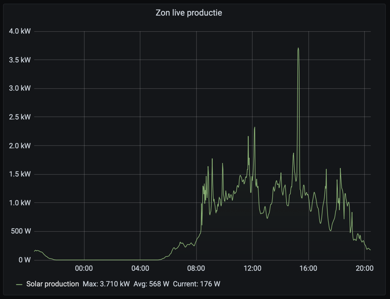

I push all template sensor values to influxDB to be able to graph them neatly:
You can get many more values by just adding more template sensors, just look at the XML that the inverter spits out:
