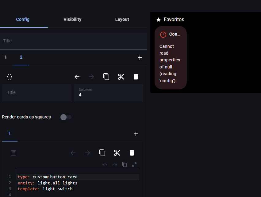

Cannot read properties of null (reading 'config') in button-card
Hello guys,
I’m very new to HA.
And I tried to replicate some advanced dashboards that I saw online, on Git and YouTube. Easyyyy I thought :sweat_smile:
I reached a problem that I have been searching online and in the forum for a resolution, even in the documentation, but I still didn’t find out what is going wrong.
I started a new dash and added:
button_card_templates:

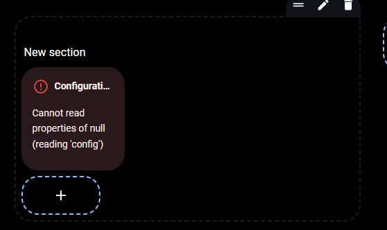

Before the views.
But everytime i try to use the button with the template, it shows an error:
Cannot read properties of null (reading ‘config’)
I have HACS and button-card installed.
I’m using UI mode, not YAML. And I still want to use it in UI, at least for now…
What am I doing wrong?
I know this probably is something silly I’m not seeing.
Thanks in advance, guys.

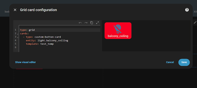

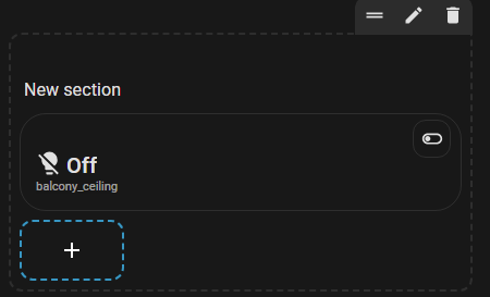

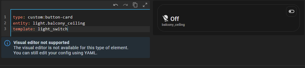

Just for testing, I merely added the posted code as a CARD (not a template), i.e. like
type: custom:button-card
entity: light.balcony_ceiling
variables:
... and so on
and it somehow works (no idea how since you posted a huge & complicated code - please next time avoid doing that, always MINIMIZE a code before posting, and also there is a high probability that you will fix the issue by yourself while minimizing).
No error on a screen, no errors in browser console.

Yes i did put before the views… If i put the template inside the button it works for me too. But trying to call:
template: light_switch
It doesn’t for some reason.

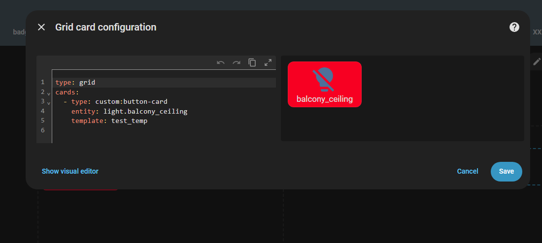

Asked you about that since you posted a screenshot w/o the error.
So I am confused what your status is.
Arrrr, I see, you pasted a whole template code - and it works. Now I got it.
So, next question - are you sure that you pasted your templates into SAME dashboard?

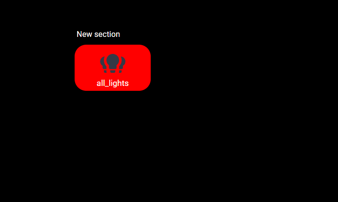

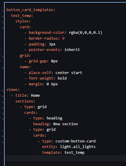

Just created a new dash with a new basic template, added it on the button, and error:
Adding the code on button directly. Works :scream:
Very weird, and cannot confirm…
I am using button-card 7.0.1
Can you post that super short code?
Ofc… I will put an even smaller code, just with color
  test_temp:
    styles:
      card:
        - background-color: rgba(255,0,0,1)
views:
  - title: Home
    sections:
      - type: grid
        cards:
          - type: heading
            heading: New section
          - type: grid
            cards:
              - type: custom:button-card
                entity: light.all_lights
                template: test_temp
My version is 7.0.1 aswell.
Just in case, try purging a browser cache…
