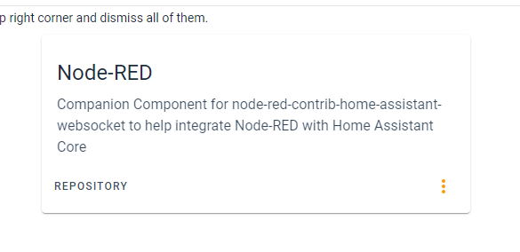

I’m having issues.
I’ve installed it in HACS…
Then I followed this, " 1. In the Home Assistant UI go to “Configuration” -> “Integrations” click “+” and search for “Node-RED”, but cannot see Node-RED…
Step #7 - https://github.com/zachowj/hass-node-red/blob/main/README.md
Thank you!
