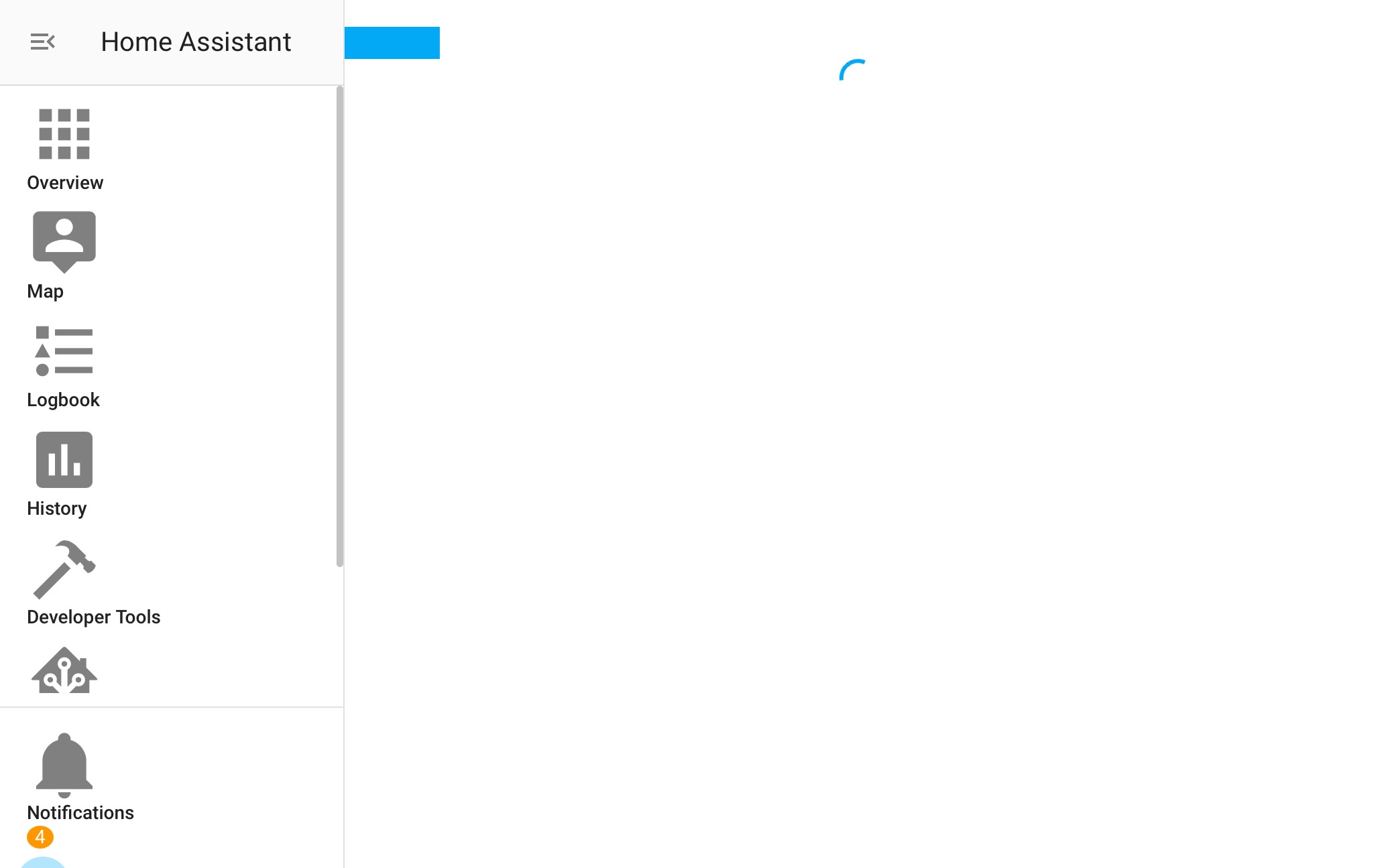

I can not do anything on home assistant, can access it from iPad but just get a spinning icon.
Also it didn’t use to have the icons on the left side.
Click on the Notifications icon. That may give you some indications. Its also possible that you need to clear the cache on your browser.

I can’t click on anything, just get the spinning icon continuously, will try clearing the cache and report back.
Thanks for the advice.

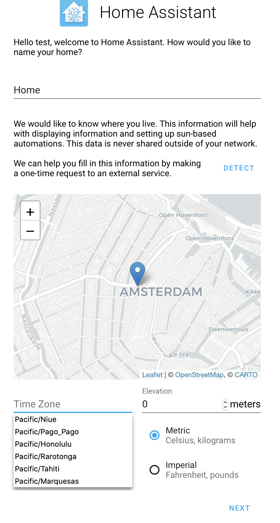

Have reloaded again, now get stuck on the page where it asks where you live. I click detect location, which it finds then when I press next a box appears with the word Fail in it.

Skip the autodetect for now. Get set up and get the add-ons for SSH and Samba installed. Then you can edit the configuration.yaml file to add the latitude,longitude, and elevation.

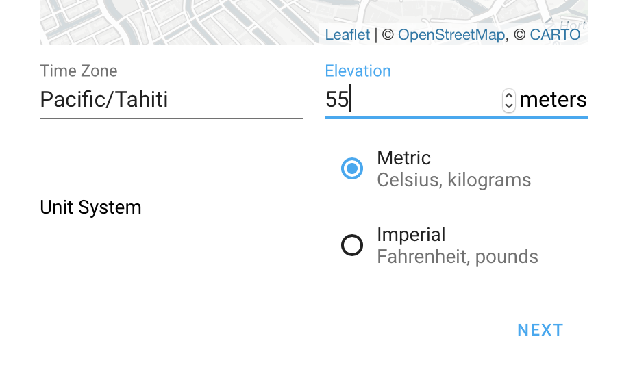

You should see a screen like this…
Select Time Zone from the list, and enter an elevation, THEN select Next.

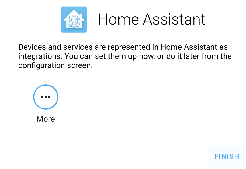

From there you can either enter integrations, or select Finish.
I would just select Finish, its easy enought to get to the menu and add integrations later.
