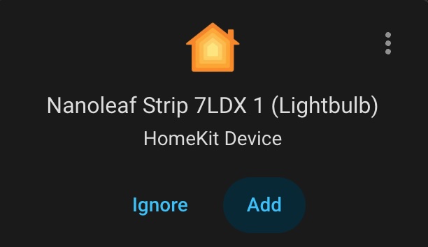

I have followed all possible ways to integrate these two products as Homekit devices. However, only the lightstrip can be discovered by HASS, but can’t be added to HASS because of the error shown below, and no matter how, it refuses to accept any pairing code.

It was astonishingly simple for me to integrate the Nanoleaf Essentials LED lightstrip. I plugged in the lightstrip, and the Matter (BETA) integration was automatically discovered by HA. I then clicked on “+ ADD DEVICE” and was instructed to use a mobile device. (If you already have a Matter device integrated, then you’ll need to first click on “devices” from the integration page for Matter.) From the HA app on my iPhone I did the same and was instructed to scan the code with my iPhone camera on the cover of the instruction manual. And that was it; 5 entities appeared. Total time was about two minutes.
I did not have any previous Matter devices installed. I did not install the Nanoleaf app and communicate directly with the device. I only have Zigbee and Z-wave dongles. I’m running HASS OS on Intel bare metal with Bluetooth. I have no idea how the Nanoleaf device communicates. One clue is that I bought a second strip and tried to integrate it from the installed location, but the setup from the mobile app took a long time and failed. I then plugged in the device about ten feet away from the computer running HA and it synced rapidly. For that reason, I suspect it’s using Bluetooth for the initial setup, then an IP connection?
For me, everything happened automagically, but I’m not complaining. (Based on my experience, I would suggest plugging the device in for setup close to your HA server and have Bluetooth activated.)
I’ve just finished going through this with Nanoleaf Essentials Light Strips and Essentials Light bulbs. Here is the way I got it to work with both Home Assistant and Homekit at the same time.
  1. Add the nanoleaf device to Apple Home.
  2. Remove the device from Apple Home which will cause it to show up in Home Assistant. Note: if the device is also in Nanoleaf app, this will fail. Delete the device from all apps, then start over at step 1.
  3. Add the device to HA using the Hokekit code on the device. xxx-xx-xxx is the proper code format…use the hyphens.
  4. Once the device is in HA, you can add a HomeKit bridge in HA which will then cause it to show back up in Apple Home if needed.
