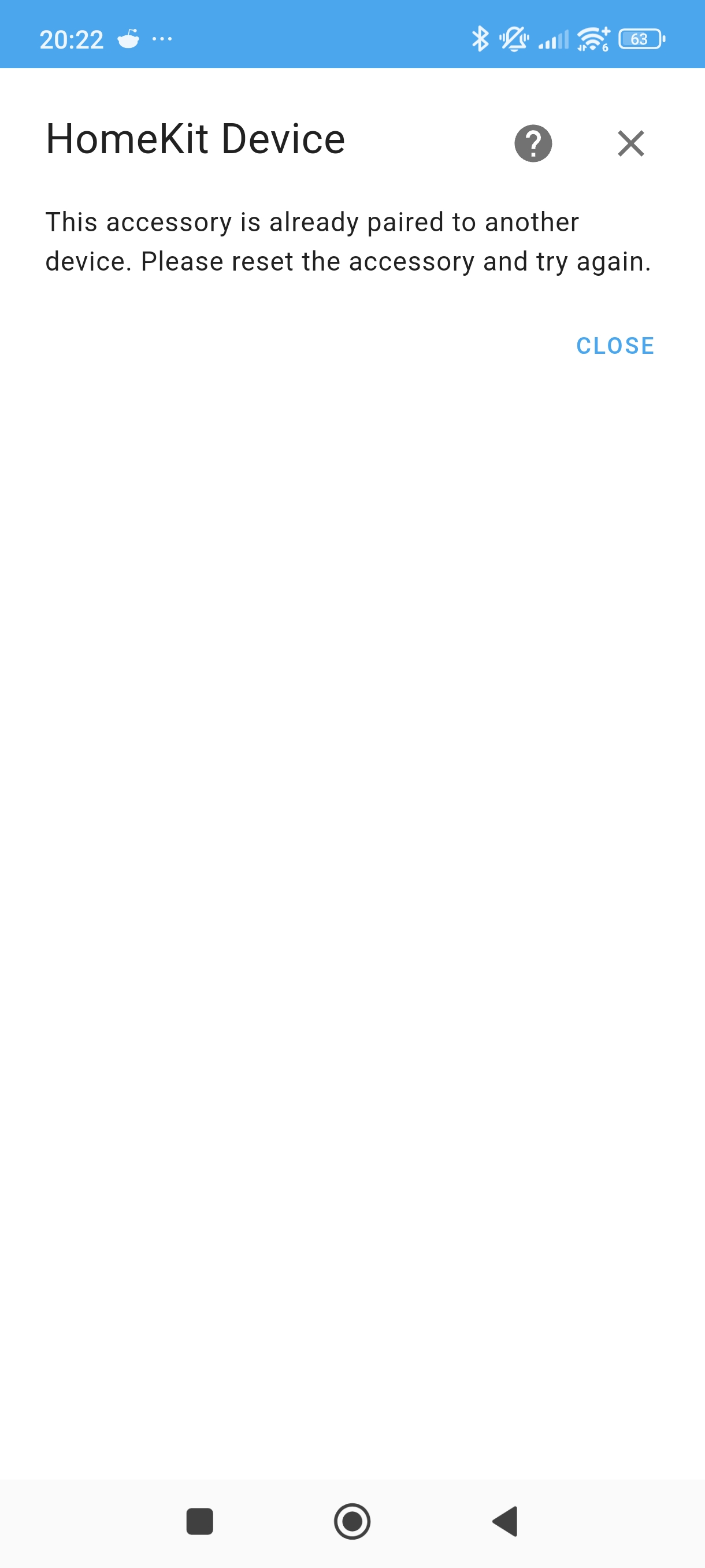

Unable to add eve lights
I’m always be able to add all the eve lights using this method:
Added device to the home kit first, after successfully device integration on the home kit, I removed the device from HK and then it appears on the Home Assistant as a new device to be added and I inserted the PIN code, and the device is ready to be used on HA without any problem.
Now I try to followed all the steps mentioned before, but the device doesn’t accept de PIN code, or send mesage mentioning that devices is already paired with other system/home, and this is not correct once the device as previously removed from the Home KIT platform.
Can you please help me in order to try solve this issue?
TYA
This doesn’t work, I try remove the eve flare from HK when the device is on the base charging, the device apear on HA, but after the code inserted, I have the following error
