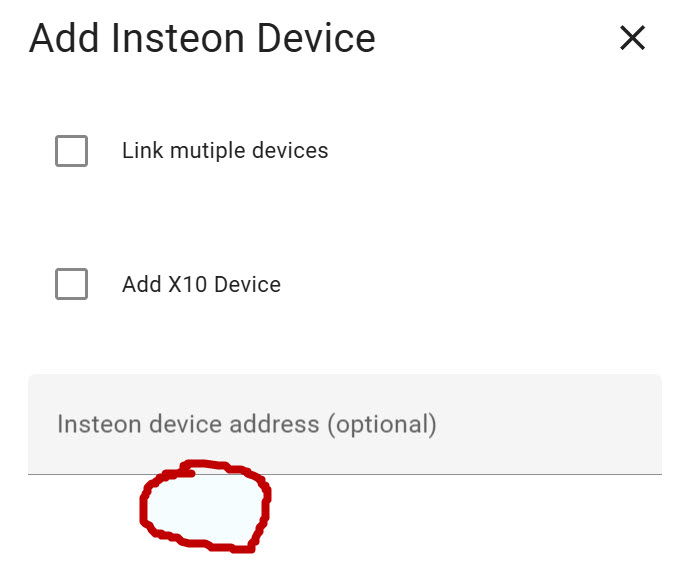

I’m starting to move my old home automation devices to Home assistant. I have lots of Insteon devices. I want to do this slowly, a device at a time so I purchased a PLM for HA.
I was able to install the Insteon Integration, able to add the modem and was able to remove a insteon device from my old automation system and add it to HA successfully.
When I try to add my third device I get the below message. This is even before I identify the address of this third insteon device. HA doesn’t want to let me add a third device it seems.
Anyone have any idea whats going on here?

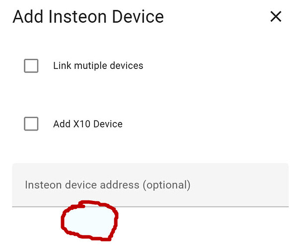

I’m having the same problem but I found something that might help.
Goto HomeAssistant Settings-Devices and Services, Insteon, configure,+ Add Device
Once there click in the area below “Insteon device address (optional)”
(Not in the text box, but below it)
I think the button is there, you just can’t see it.
That did the trick. Thanks.
