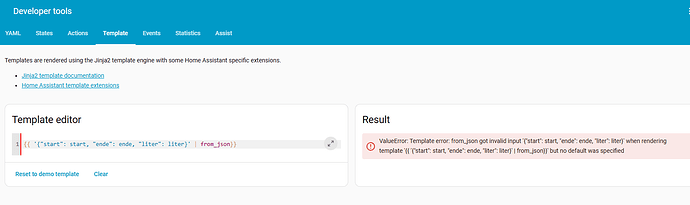

However, transferring this to my code:
    new_entry: |
      {{ '{"start": start, "ende": ende, "liter": liter}' | from_json}}
yields :
ValueError: Template error: from_json got invalid input ‘{“start”: start, “ende”: ende, “liter”: liter}’ when rendering template ‘{{ ‘{“start”: start, “ende”: ende, “liter”: liter}’ | from_json}}’ but no default was specified
Why this is invalid input?

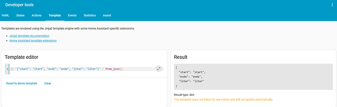

Check your quotes, two of which seem to be left double quote. The you cannot have a value like start it should be "start"
Your example:
Corrected:
{"start": "start", "ende": "ende", "liter": "liter"}
You do not need to use from_json to assign a dictionary as the value of a variable and attributes can hold non-string data types, so you shouldn’t need to do any conversions.
