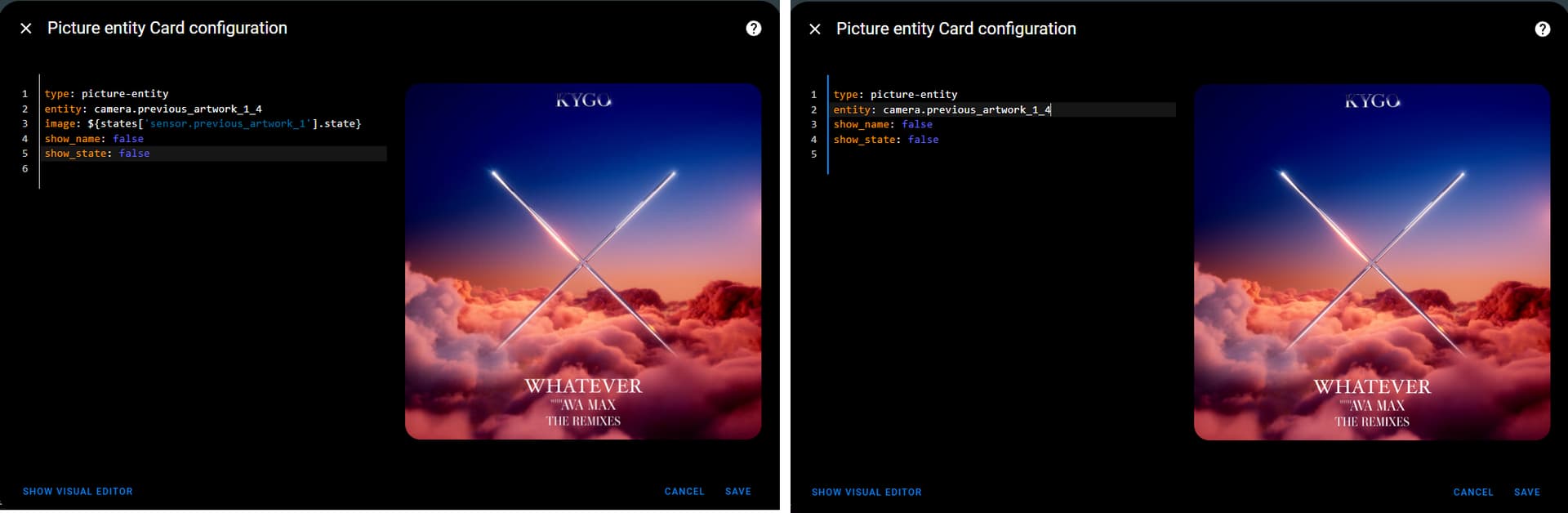

Re: image: ${states['sensor.dynamic_image'].state} Will work only if this card is inside config-template-card - this is not true. It works in picture-entity cards also:
- type: picture-entity
  entity: camera.previous_artwork_1_4
  image: ${states['sensor.previous_artwork_1'].state}
  show_name: false
  show_state: false

Absolutely wrong. None stock card supports JS templates.
Probably your example card is placed inside config-template-card.
Or the image is provided by a camera entity.
My bad, you’re right, it’s being provided by the camera entity. I hadn’t noticed this previously until you just mentioned it.
