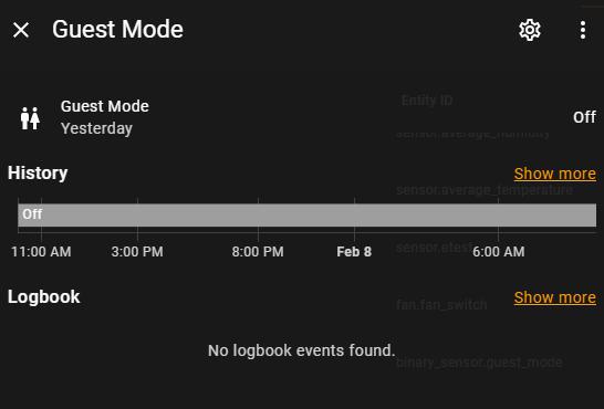

I created a basic template sensor using the helper UI. For the life of me i can’t figure out how to now edit it. When I click on it in the helper screen it brings up the history window. Is this a bug or am i missing something obvious?

so i’m not seeing the template options?
