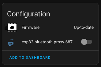

I have ESPHome in integrations, here is what I see inside. All seems fine, except I can’t enable the bluetooth proxy by flipping the toggle in the proxy card.
I do not see a switch in the respective package to enable/disable the Bluetooth proxy:
There is no switch to disable the proxy. Once it’s configured in HA, it should just work.

The switch you see is from the fritzbox integration. (you see 2 integrations on the left for the device). It shows if the device is allowed internet access, and this particular switch doesn’t allow changing from HA. It is off for me too, and the proxy works just fine. (It should have been a binary sensor, not a switch in the first place).
That is not to say you may not have a problem if the esp disconnects, it just isn’t related to the switch, nor can you set it other than from the fritzbox by assigning it a profile. In general it is good practice that iot devices have no internet access if they do not need it, and this one does not.
