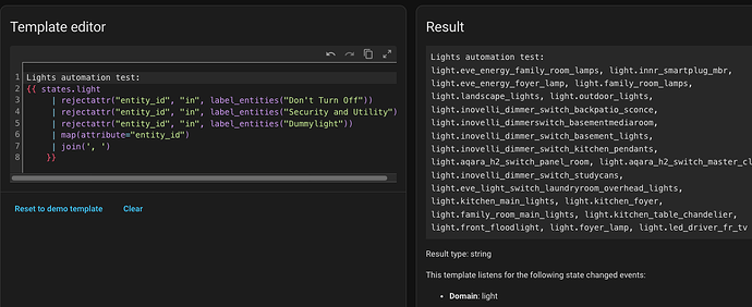

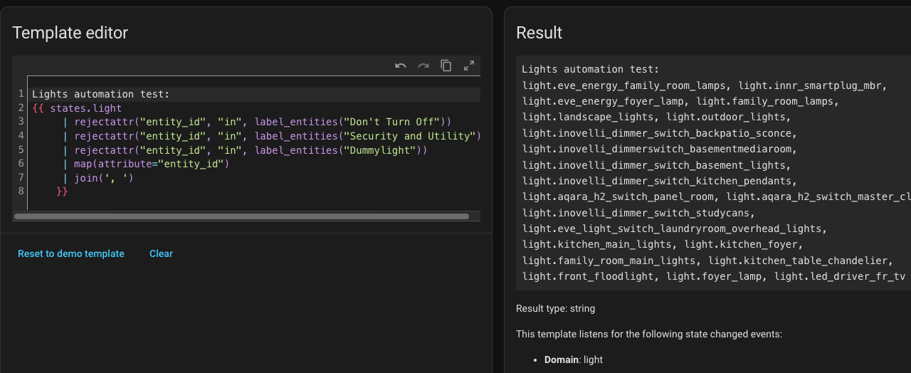

Does the template return the expected values in the Template editor tool?
Yes it does! I don’t understand why it won’t translate to the light.turn_off action.
