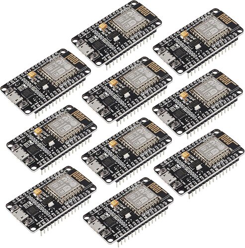

This is the nodemcu I am using:

It sounds like you bought ones that have to be put in bootloader mode in order to be flashed. If that is the case, there is a button on the board that must be held down when it is initially plugged it. I can’t help on when exactly to let up on the button because I haven’t had much luck with the couple that I have bought with that feature.
EDIT: Zooming in on the photo of boards from Amazon listing, it does look like yours have the flash button indicated by red arrow. The blue arrow is a reset button.

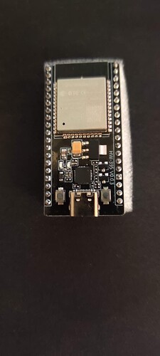

I got my ESP32 to flash by holding down the flash button (right of usb-c) while plugging in and continuing to hold the flash button while starting the flash process from espweb.
