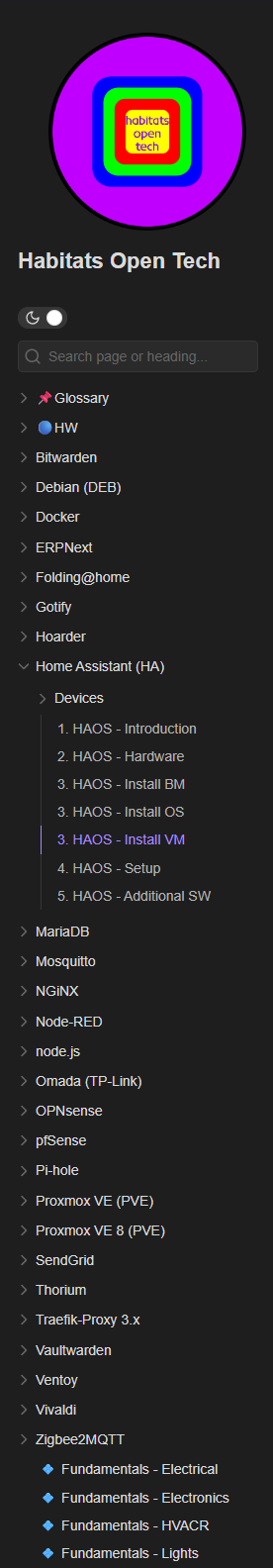

Or if you want full control over the installation process use my guides with guaranteed results.
