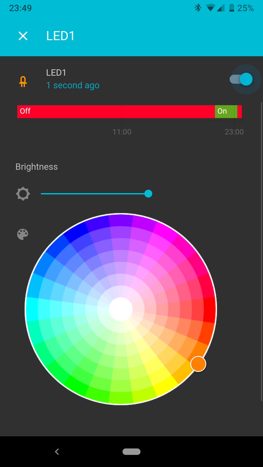

It now appears in states and I can activate it however, using the lovelace LIGHT card only lets me control brightness, how do I get the colour wheel so I can select actual colour?
Long press on the light to bring up the full options…
Note color wheel only appears when strip is on.
That didnt work but i found clicking the three dots in the top right hand corner does, thanks again.
