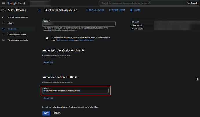

I’ve been struggling with trying to repair my Nest integration (Removed Application Credentials many times) and finally deleted my Home Assistant related projects from Google Console and completely rebuilt, following the instructions on Google Nest - Home Assistant page and I’m up and working again.
It actually seemed easier this time without having to use a “callback” URI with dynamic DNS (maybe this is what was preventing me from repairing my old project and causing the error).
Thanks to those that provided the instructions.
This is actually super helpful. If you don’t mind - what prevents you from needing the callback URI?
if you’re in console.cloud.google.com it used to require a viable public callback address (URI) “yourdomain.com” but going through the new instructions the console doesn’t ask for that any longer, just a generic "https://my.home-assistant.io/redirect/oauth"
