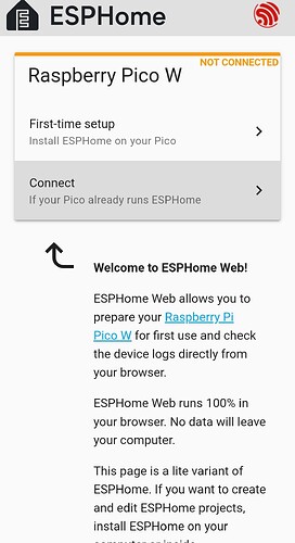

Did you try web installer?
https://web.esphome.io/
Yes i tried that even that doesnt seem to work. Do you know of a step by step guide to setting up a simple control of a gpio on esp32 or pi pico w?

ESPHome Web runs 100% in your browser. No data will leave your computer. I assume this runs similar to the tasmota version and for first install on the pico shouldn’t tax a pi b3. OP may not be using correct cable or even a cable at all. OP may not be using correct model of pico. Subsequent compiling on pi will likely crash it.
