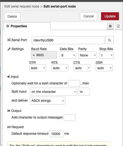

Possibly a helpful datapoint, I’ve also tried sending the command via Node Read serial-port node and it times out (like it too is not getting any output). Config for that:
