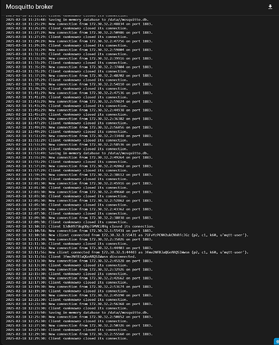

So I went into the mosquito broker to see what I could learn but I’m not sure what I’m looking at. I have MQTT working for my car through onstar so I believe that is what is showing up here. I don’t think frigate is connecting via MQTT but I’ve done everything in the configuration file that it said to do.

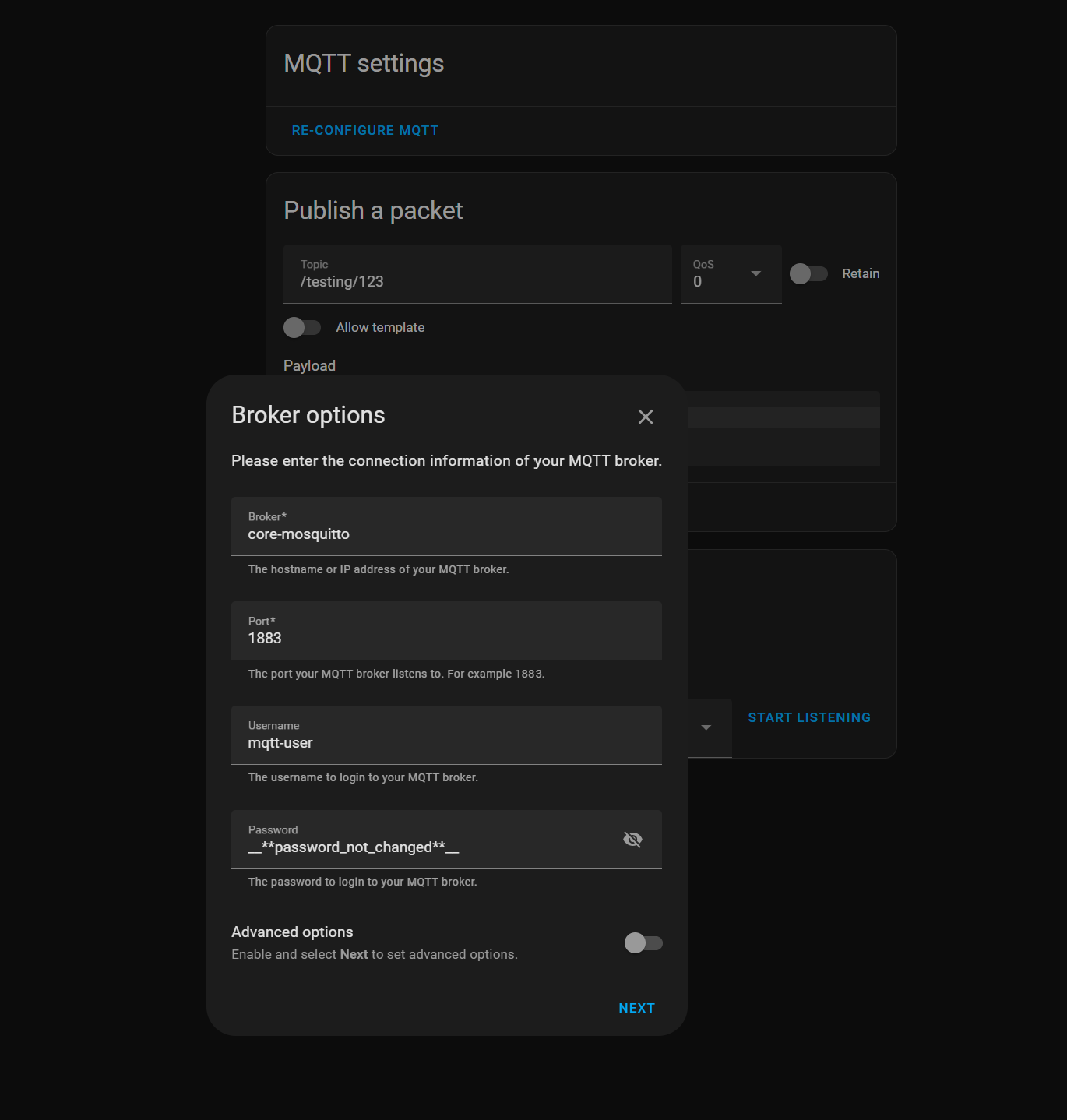

I have both the Mosquito broker addon and the MQTT integration. I tried to create a user in the broker addon but that didn’t work either. When I set up the broker and the integration I created a HA user specifically for MQTT called mqtt-user with a unique password. Like you mentioned, those credentials should work in the frigate.yaml configuration but I’ve obviously done something wrong somewhere.
In the MQTT integration I have one device, which is my car. There is no device for the camera and no button anywhere to add one. I’ve tried to re-configure the integration with the Username and password but it doesn’t seem to save. Every time I go back in the password says ,“password_not_changed.”
Fundamentally, the problem is I don’t know what the integration does vs the addon or how they work together. I am able to publish and test packet and it does come back, so the integration is working. I just can’t get frigate to connect.

As always it was something very simple that I messed up. In the frigate.yaml file where you configure the mqtt settings under “host” I put the domain of my home assistant since that was what the tutorials said to do. I replaced that with “core-mosquitto” and it all started working. I noticed this discrepancy when I went into the MQTT configuration and the broker was listed as core-mosquitto. I tried changing that to my domain and couldn’t connect to the broker. So I decided to change the ip address in the frigate.yml file and voila!
