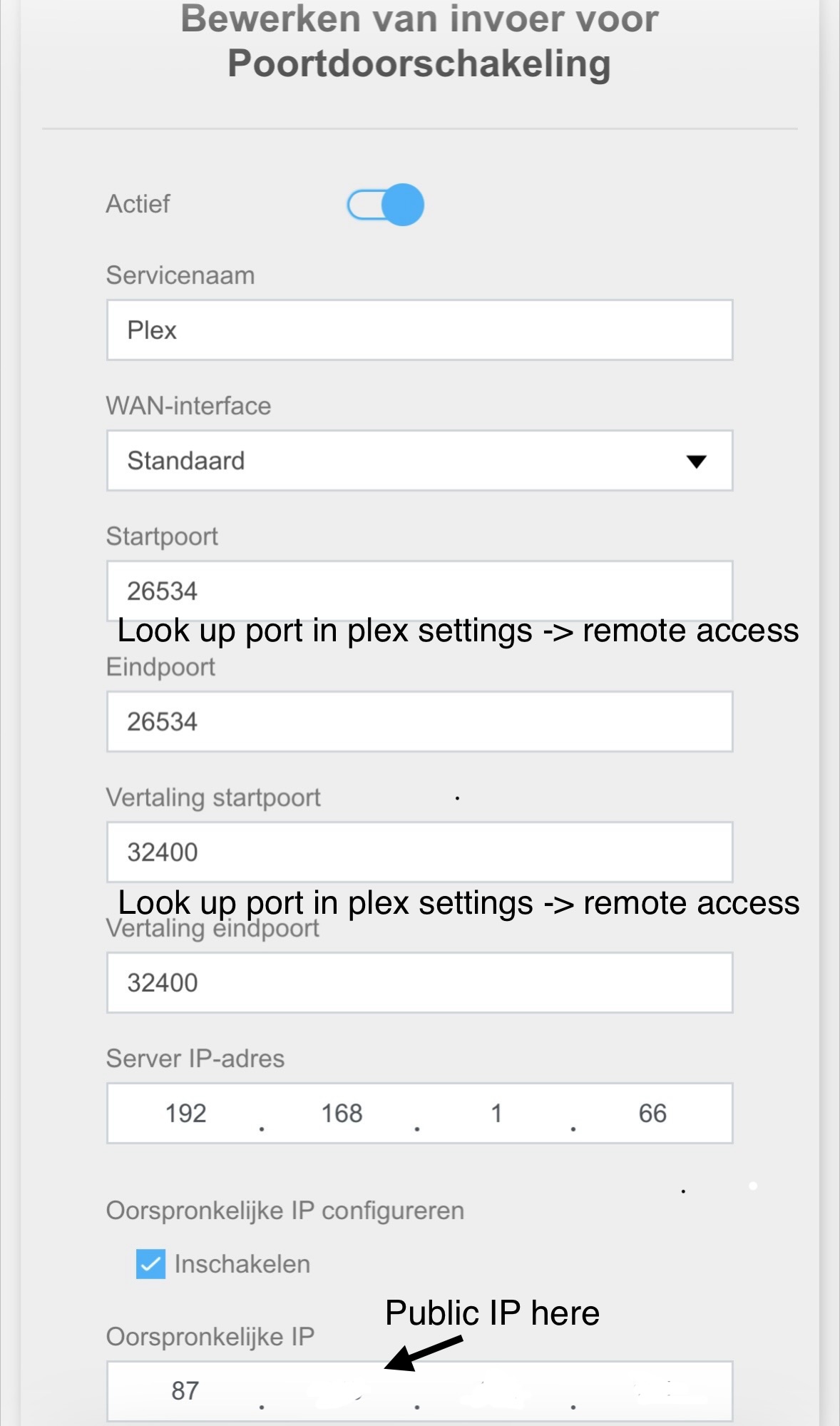

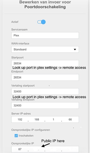

In the Netherlands, using T-Mobile Zylex
Managed to get it working by adding a Nat rule looking like this
