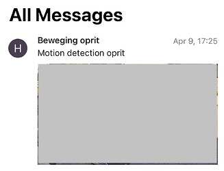

Since yesterday I have problems with the image in the notification. It was working great until then. Suddenly it’s not working anymore.
It’s just the notification to ios which gives a problem as in the same automation in parallel I also send a notification to pushover and telegram and there it is working.
