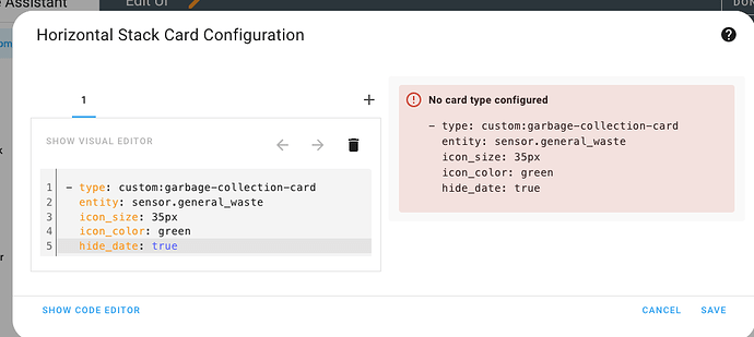

Sadly I still get this error.
Have you tried it in the way as shown in my Screenshot?

the card shows up in my www folder and I also have the integration in my dashboard resourses (URL) I was able to create helpers easily but when i go to input the manual card code and change the sensors to my helper i continue to get a no card type configured.
I have exactly the same issue and have completed all the pre-requisite steps…
Maybe the card have no visual editor available.
It looks like you can still save it though.
I am stuck at the same point as you, getting the same error message:
No card type configured
  • type: custom:garbage-collection-card.
