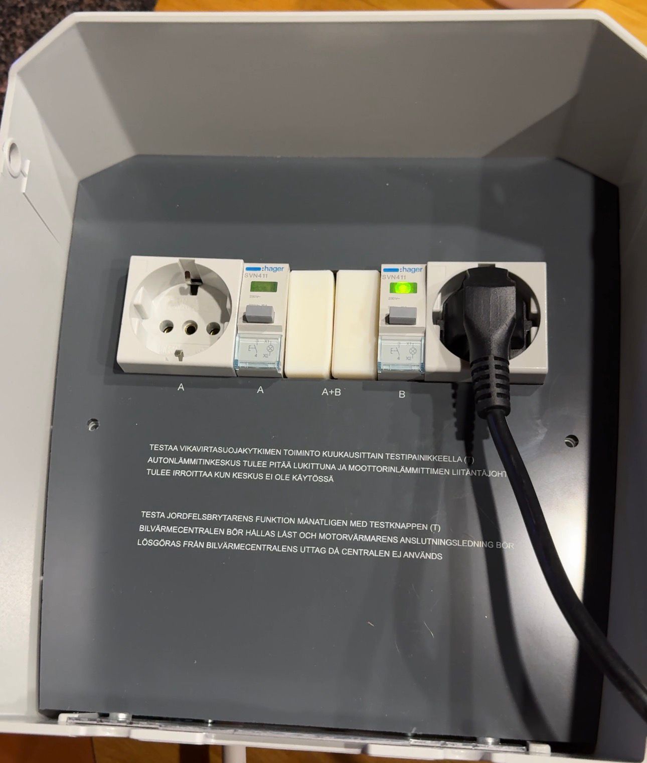

I’m planning to automate my car heating setup and would appreciate some advice on the best approach.
Current situation
  • I have 2* standard 230V outlet for engine/block heating.
  • Control is currently manual or based on simple timers.

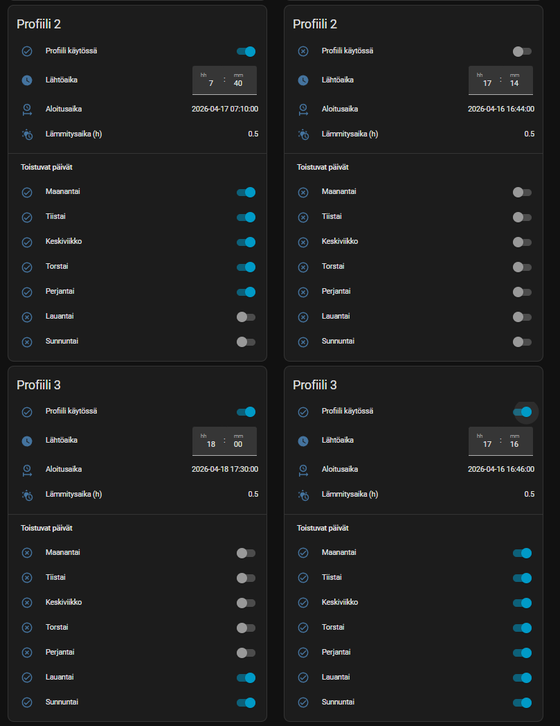

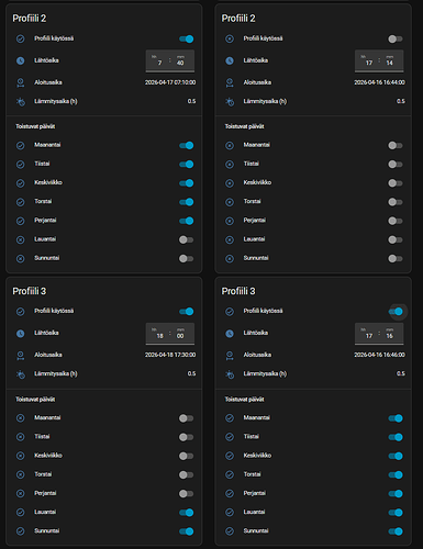

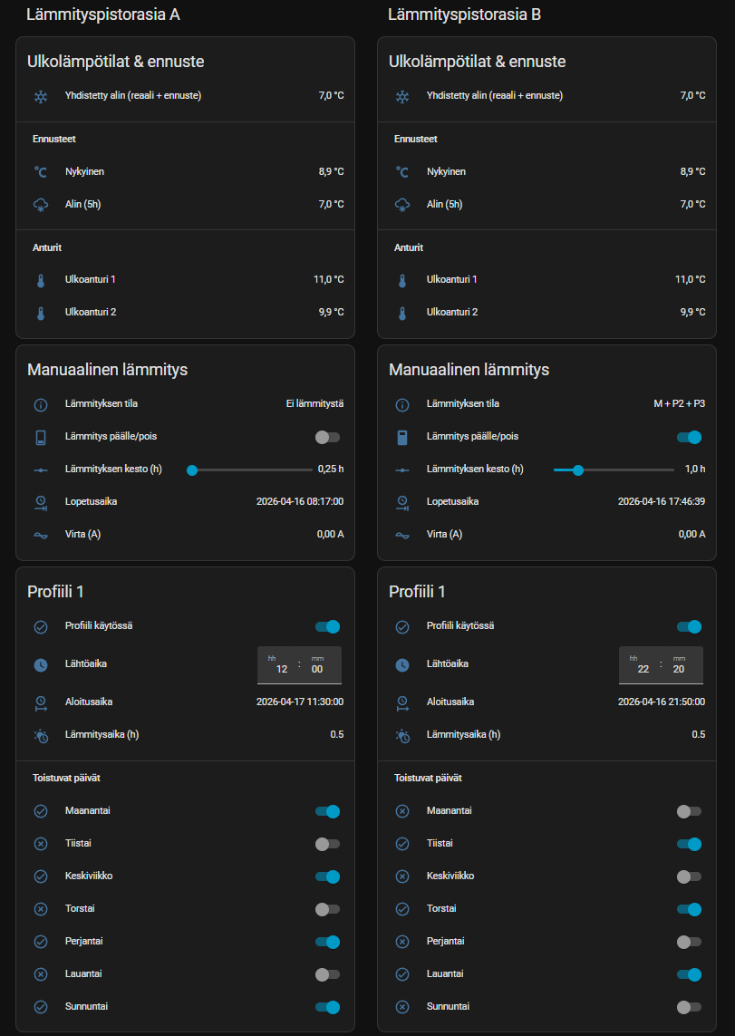

I also have UI cards:
type: vertical-stack
title: Lämmityspistorasia A
cards:
  - type: entities
    title: Lämpötila
    entities:
      - entity: sensor.outdoor_temperature_min
        name: Kylmin ulkolämpötila
        icon: mdi:snowflake
      - entity: input_button.update_car_heating_calc
        name: Päivitä lämmityslaskenta
        icon: mdi:refresh
  - type: entities
    title: Manuaalinen lämmitys
    entities:
      - entity: switch.autolammitys_a
        name: Lämmitys päälle/pois
      - entity: input_number.manual_heat_duration_1
        name: Lämmityksen kesto (h)
      - entity: sensor.shelly1pmg4_xxx_current
  - type: entities
    title: Profiili 1
    entities:
      - entity: input_boolean.autostart_1_1_enabled
      - entity: input_datetime.autostart_1_1
      - entity: sensor.car_1_heat_start_1
        name: Laskettu aloitusaika
      - type: section
        label: Toistuvat päivät
      - entity: input_boolean.autostart_1_1_mon
      - entity: input_boolean.autostart_1_1_tue
      - entity: input_boolean.autostart_1_1_wed
      - entity: input_boolean.autostart_1_1_thu
      - entity: input_boolean.autostart_1_1_fri
      - entity: input_boolean.autostart_1_1_sat
      - entity: input_boolean.autostart_1_1_sun
  - type: entities
    title: Profiili 2
    entities:
      - entity: input_boolean.autostart_1_2_enabled
      - entity: input_datetime.autostart_1_2
      - entity: sensor.car_1_heat_start_2
      - type: section
      - entity: input_boolean.autostart_1_2_mon
      - entity: input_boolean.autostart_1_2_tue
      - entity: input_boolean.autostart_1_2_wed
      - entity: input_boolean.autostart_1_2_thu
      - entity: input_boolean.autostart_1_2_fri
      - entity: input_boolean.autostart_1_2_sat
      - entity: input_boolean.autostart_1_2_sun
  - type: entities
    title: Profiili 3
    entities:
      - entity: input_boolean.autostart_1_3_enabled
      - entity: input_datetime.autostart_1_3
      - entity: sensor.car_1_heat_start_3
      - type: section
      - entity: input_boolean.autostart_1_3_mon
      - entity: input_boolean.autostart_1_3_tue
      - entity: input_boolean.autostart_1_3_wed
      - entity: input_boolean.autostart_1_3_thu
      - entity: input_boolean.autostart_1_3_fri
      - entity: input_boolean.autostart_1_3_sat
      - entity: input_boolean.autostart_1_3_sun
I’m really new to HA and this is my first real automation :smiley:
Thanks in advance for any suggestions or examples!

Also did little changes to UI:
cards:
  - type: entities
    title: Ulkolämpötilat & ennuste
    show_header_toggle: false
    entities:
        name: Yhdistetty alin (reaali + ennuste)
        icon: mdi:snowflake
      - type: section
        label: Ennusteet
      - entity: sensor.temperature
        icon: mdi:temperature-celsius
      - entity: sensor.forecasted_min_5h_temperature
        icon: mdi:weather-snowy
      - type: section
        label: Anturit
      - entity: sensor.hue_outdoor_motion_sensor_1_temperature
        icon: mdi:thermometer
      - entity: sensor.hue_outdoor_motion_sensor_2_temperature
  - type: entities
    entities:
      - entity: sensor.car1_heating_reason
        icon: mdi:information-outline
      - entity: sensor.car_1_heat_end_manual
        icon: mdi:clock-end
      - entity: sensor.shelly1pmg4_xxxxx_current
  - type: entities
    title: Profiili 1
    entities:
        icon: mdi:clock-start
      - entity: sensor.car_1_duration_1
        icon: mdi:sun-clock
      - type: section

I made some more changes :slightly_smiling_face: mainly bug fixes and improvements.
There was a feature where even if you turned a profile off, it would still start heating if the heating start time had already been calculated. Also, it would overwrite manual heating if automatic heating started while manual heating was active.
So I moved the departure and start times to the past if the profile is off:
