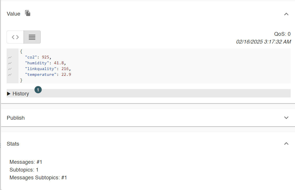

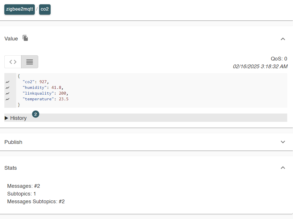

@nick4275 It is ignoring the chatter, but uses the fixed interval to aggregate data before publishing. But it mimics a deboucne behavior. It is more like filter of the messages. If you have MQTT Explorer you can see the chatter of the device.
Below screenshots are from my CO2 sensor. 1 minute apart and in the stats is visible that only 2 messages are passed.

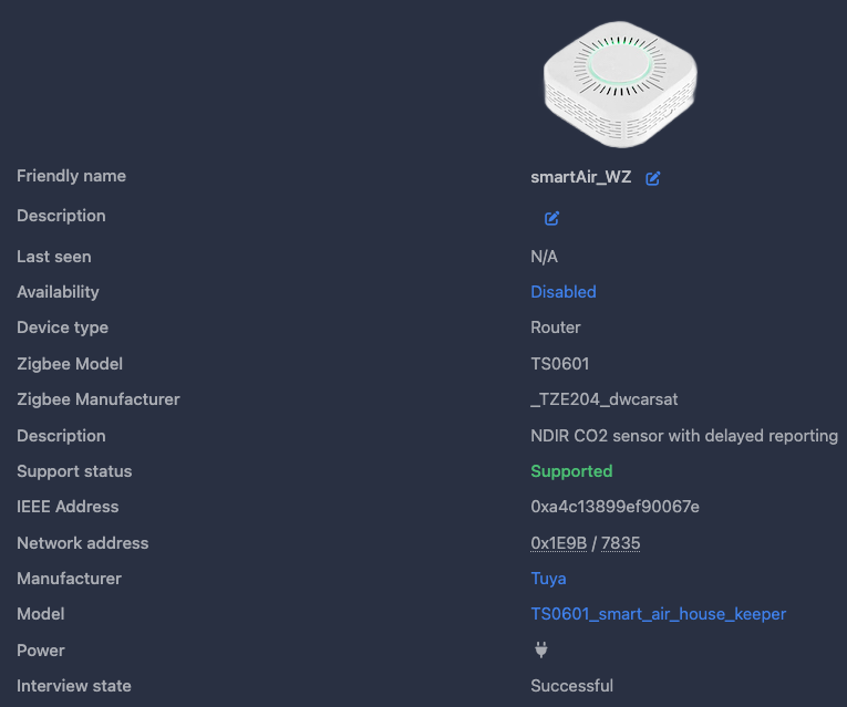

Regarding script not working. Check your “Zigbee manufacturer” in About page of your device in Z2M
And adapt the script at line 35:
fingerprint: tuya.fingerprint(‘TS0601’, [‘_TZE200_3ejwxpmu (replace this with yours)’]),

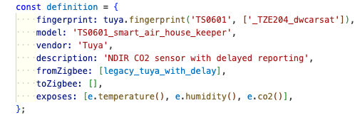

I had the same issue with few very chatty CO2 sensors and I have applied the suggested GitHub fix, with the following modifications to address my own sensors:
const definition = {
    fingerprint: tuya.fingerprint('TS0601', ['_TZE204_dwcarsat']),
    model: 'TS0601_smart_air_house_keeper',
    vendor: 'Tuya',
    description: 'NDIR CO2 sensor with delayed reporting',
    fromZigbee: [legacy_tuya_with_delay],
    toZigbee: [],
    exposes: [e.temperature(), e.humidity(), e.co2()],type or paste code here
Now I’m monitoring the stability of the Zigbee Network.
