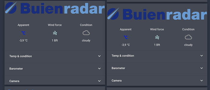

and another challenge, which is probably easy, but at the end of the day…
  - type: custom:fold-entity-row
    head:
      type: section
      label: Camera
    padding: 0
    entities:
      - type: custom:hui-element
        card_type: picture-entity
        card_mod:
# document.querySelector("body > home-assistant").shadowRoot.querySelector("home-assistant-main").shadowRoot.querySelector("app-drawer-layout > partial-panel-resolver > ha-panel-lovelace").shadowRoot.querySelector("hui-root").shadowRoot.querySelector("#view > hui-view > horizontal-layout").shadowRoot.querySelector("#columns > div:nth-child(1) > hui-entities-card:nth-child(9)").shadowRoot.querySelector("#states > div:nth-child(5) > fold-entity-row").shadowRoot.querySelector("#measure > div > hui-element > hui-picture-entity-card").shadowRoot.querySelector("ha-card > hui-image").shadowRoot.querySelector("#image")
          style: |
              div#container.image {
                margin: 0px -16px -16px -16px;
              ha-card {
                box-shadow: none;
I want the picture to take the full width in the fold, and not respect the margins…
path in inspector:
normally, this works:
        card_mod:
          style: |
              ha-card.type-picture-entity {
                box-shadow: none;
but the only thing modded is the box-shadow.
Ive had fights like this with folded Map cards, and they are successfully modded with:
      head:
        type: section
        label: Map
      card_mod:
        style: |
          div#items {
            margin: 16px -16px -16px -16px;
no so this case ;-((
Adapt this for your needs:
type: entities
entities:
  - sun.sun
  - sun.sun
  - type: section
  - sun.sun
  - sun.sun
    head:
      type: section
      label: Camera
      card_mod:
        style: |
          :host {
            overflow: visible !important;
            margin-bottom: 8px;
    padding: 0
    open: true
    entities:
        entity: input_boolean.test_boolean
        image: /local/images/blue_low_2.jpg
    card_mod:
      style: |
        div#items  {
          margin-left: -16px;
          margin-right: -16px;
          margin-bottom: -16px;
        :host {
          margin-bottom: 16px;
  - type: section
    card_mod:
      style: |
        .divider {
          margin-top: 16px !important;
  - sun.sun
  - sun.sun
Not as elegant as it could be - not 100% perfect: the image’s top edge is not on the same height as the divider when folded. This is happening because of using entities card. You should use stacks instead.
Compare with stack solution:
thanks. Tried the full stack-in-card, but that has various other ugly results. Mixing it like:
    card_mod:
      style: |
        div#items {
          margin: 8px -16px -16px -16px;
#        :host {
#          margin-bottom: 16px;
    head:
      type: section
      label: Camera
    padding: 0
    entities:
      - type: custom:stack-in-card
        keep:
          background: true
        cards:
#            card_mod:
#              style: |
#                  ha-card {
#                    box-shadow: none;
            entity: camera.buienradar
makes it show as I want, folded and unfolded!

@Mariusthvdb could you post pictures for folded & unfolded?
sure, left full stack-in-card, right my (entities) card with bottom stack-in-card (and especially note the height of the fold title row, which seems better I the right version:
folded:
opened:
here’s the full code for the right card (which I have changed to use a picture card for the top banner, didnt have that one yet in the config :wink: and seems even more adequate than what I had before:
