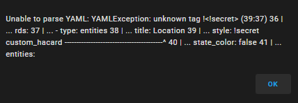

Hi I tried the method you’ve mention but keep getting a YAML error. Any ideas?
The style works fine when in my code but I have it in for every card and want to tidy things up.
Thanks
Secrets are not supported in a storage mode.
Is there a method to change out of storage mode? Could you elaborate please.
How do you know I’m in storage mode from the screen shots?
It is an off-topic here.

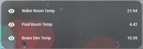

Happy New Year everyone. Looking at the post here, I am trying to do the exact same thing…
New-1
If any of these temperature sensors are offline, I would like the temperature to show in red. For each of the sensors above, I have 2 items: (sensor.water_room_temp & sensor.water_room_offline)…
      - name: "Water Room Temp"
        value_template: "{{ value_json.data['items'][0]['last_temp'] }}"
      - name: "Water Room Offline"
        value_template: "{{ value_json.data['items'][0]['offline'] }}"
sensor.water_room_offline gives me a 0 if it’s online or a 1 if it’s offline.
I read in that post that there are different ways to accomplish this however I would like to use card_mod and templates. I have played around with the syntax based on that thread but I just can’t seem to get it working.
Thanks so much in advance everyone and all the very best for a healthy, happy 2023!
1st post → link at the bottom → styles for Entities card → colored icons.
For conditional styling you may use a jinjia template similar to one you posted in a card-mod-theme thread.
Thank you for the reply. First post, got it. Link at the bottom, got it. That took me here. I wasn’t able to find the rest - I’m sorry.
The temperature (sensor.water_room_temp) color change is based on a completely different variable (sensor.water_room_offline). Do I need to define that variable like in this post or can I just reference it in an ā€˜if’ statement?
Go here
Thank you very much for your time and patience with me @ Ildar_Gabdullin. You and RobC are such a huge help to this community and I am VERY appreciative. I was making things much more complicated then they needed to be. For anyone else that may be looking to do this, here is the final code that works great…
