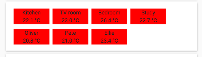

I’m trying to use card-mod to colour the background of entities on a glances card. I plan to adjust background colour according to temperature (haven’t done that bit yet). I would like to adjust padding and margin, but notice that only some of these settings don’t take.
My config:
    - type: glance
        - entity: sensor.temperature_8434
        - entity: sensor.downstairs_temperature
        - entity: sensor.inside_temperature
        - entity: sensor.temperature_study
        - entity: sensor.temperature_5534
        - entity: sensor.temperature_1902
        - entity: sensor.temperature_ellie
      show_icon: false
      style: |
        .entity {
          background: red;
          margin-left: 4px;
          margin-right: 4px;
          margin-bottom: 8px;
          padding-bottom: 4px;
          padding-top: 4px;
But looking in the inspector in Chrome, I can see that some of these get ignored.
Any suggestions as to what I can do differently?
