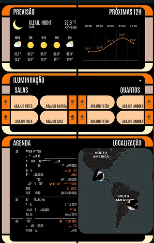

I wanted to change the font size for the weather card and successfully followed Ildars excellent guidance, many thanks!
During my initial testing I realized I needed to install this card-mod. Once I did this my header bar with the tabs was moved to the bottom instead, see print screen below. I have no idea how to fix this (move header bar back to the top) and would appreciate if anyone would be able to guide me please?
