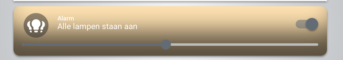

🔹 Card-mod - Add css styles to any lovelace card

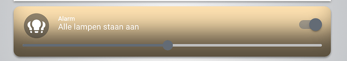

try content: " ";
but, instead of that pseudo element, just target the
            ha-icon {
              border-radius: 50%;
              border: 0px;
              background-color: rgba(44, 44, 44, 0.5);
              padding: 2px;
or, lacking a light color var (like we have in custom:button-card) use the rgb values of the actual; light
            ha-icon {
              {% set rgb = state_attr(config.entity,'rgb_color') %}
              border-radius: 50%;
              border: 0px;
              background-color: rgba({{ rgb[0] }}, {{ rgb[1] }}, {{ rgb[2] }}, 0.5);
              padding: 2px;

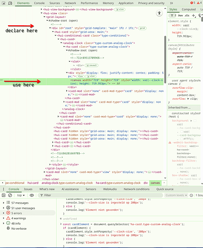

Hi there,
I’m rather new and struggling with a certain dashboard I would like to create to later on cast this to a Nest 2 Hub, but it should also be nice on a Pixel7 portrait,landscape and desktop mode.
I made a rather large declaration block and would like to use it once and not in every conditional card again and again.
The diameter: var(–clock-size) works because I adapted the normal analog clock
As I have several conditional cards. I would like to target these with one declaration block.

Can somebody tell me how to travel through 2 shadow-roots to the canvas.
Thanks for reading
Guy

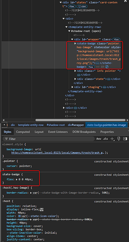

After the migration most of my card-mod is still working (thanks for this smooth transition), only in this place I am strugling how to change the code.
type: custom:auto-entities
card:
  type: entities
filter:
  include:
    - entity_id: sensor.abholtag_art*
      options:
        type: custom:template-entity-row
        image: |
          {{state_attr(config.entity,'image')}}
          {{state_attr(config.entity,'summary')}}
        state: " "
        secondary: |
          {{state_attr(config.entity,'tage')}}

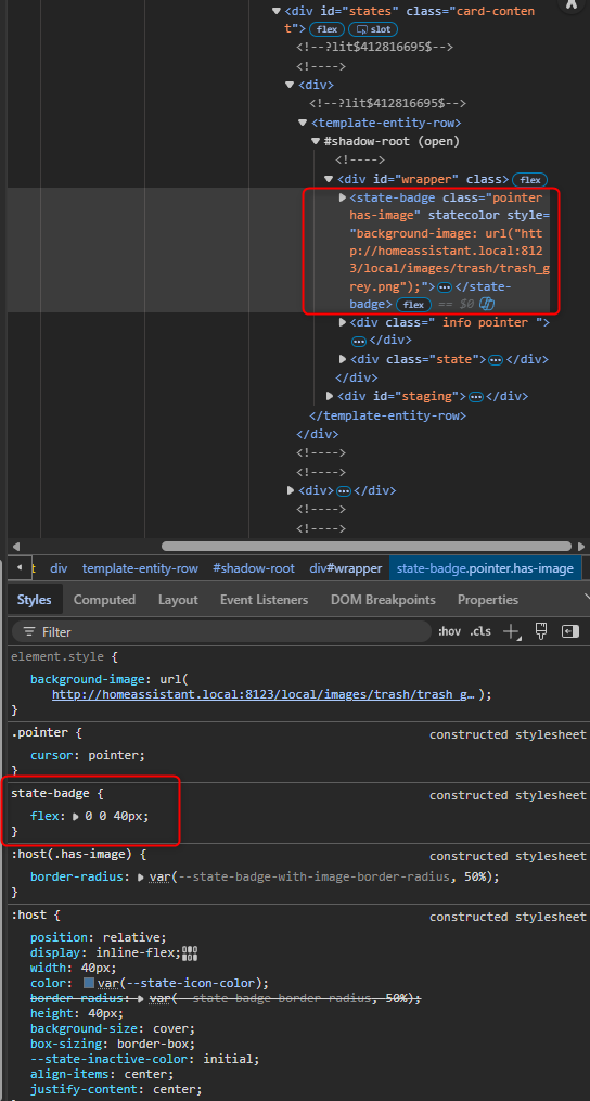

        card_mod:
          style:
            div#wrapper: |
              state-badge {
                flex: 0 0 30px !important;
                transform: scale(0.6);
                margin: -5px;
                border-radius: 0;
None of these state-badge changes is working any longer, so I assume the div#wrapper should be changed, but according to the DOM, I have no idea to what I shall change it.
The reason, why I even need this change is, that the card transforms the pictures to a quare, so I need to transform it back to the rectangle they should be.
Ive just tested that modification here

and it works just fine?
Thanks a lot for testing, so the problem must be somewhere else.
Update: After 1 more reboot and clearing the front end cache it’s working now.

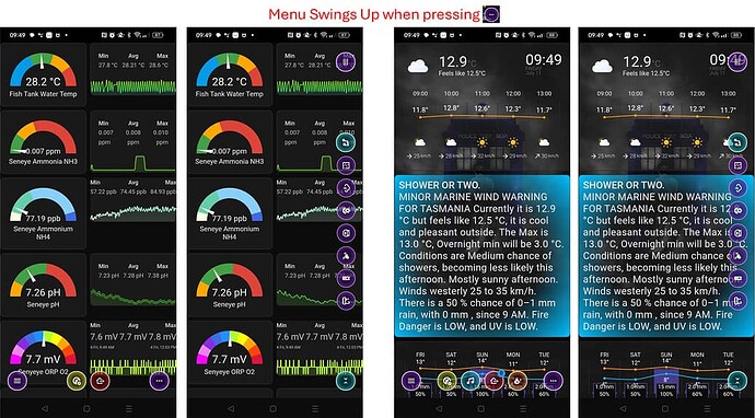

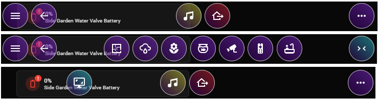

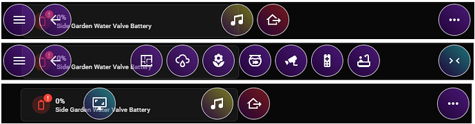

I have not updated from v3.4.6 yet. One of my major issue will be ensuring my Sticky Floating Mushroom Chips Menu still works.
I would like some advice on how upgrading to v4.1.0 will affect my Navigation Menu as it is quite pivotal to the operation of my kiosks in the home.
I have a complex list of @media queries at the bottom of the card see card-mod variants

Also card-mod applied to individual chips, through template sensors Full Card Code Here
              - type: conditional
                conditions:
                  - condition: screen
                    media_query: '(orientation: portrait) and (max-width: 768px)'
                  - condition: state
                    entity: input_boolean.chips_menu_toggle
                    state: 'on'
                chip:
                  type: template
                  tap_action:
                    action: navigate
                    navigation_path: /dashboard-bathroom/mobile
                  entity: null
                  icon: mdi:bathtub-outline
                  icon_color: white
                  card_mod:
                    style: |
                      ha-card {
                        {{states('sensor.mushroom_chip_border_1px_screen2dppx')}}
                        {{states('sensor.mushroom_chip_color_menu')}}
Your card_mod looks fine. During testing of v4 I had a test case from @Mariusthvdb of a floating menu controlled by a input_boolean, which is similar to what you have.
So no changes to my current code?
None I can see on a quick glance.

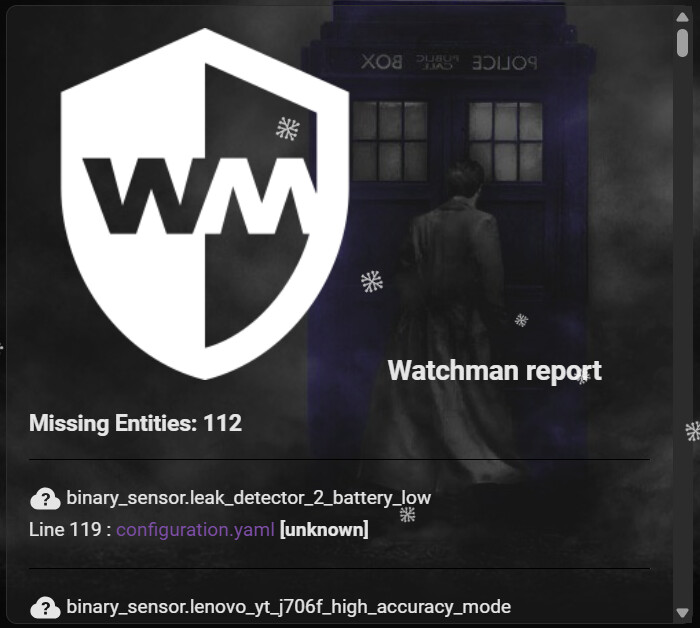

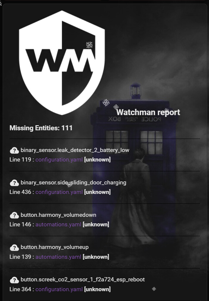

Everything else seems to be functioning fine except My Watchman Report Card (markdown) has lost its scroll overflow and has a giant logo?
type: markdown
entity_id: sensor.watchman_missing_entities
card_size: 6
card_mod:
  style: |
    ha-card.type-markdown {
      max-height: 450px;
      overflow-y: auto;
      padding: 0px;
content: >-

Update this to :host(.type-markdown) ha-card {
Also note that there are markdown issues related to Frontend itself, including issues with editing markdown card with card_mod and possible non application of card_mord. See [Bug]: Styles don't apply for markdown in editor view. · Issue #549 · thomasloven/lovelace-card-mod · GitHub.
The fix in Frontend is a one charater nullish check ‘?’.
Scroll bar is back but still a huge logo, may be related to the bug you posted.

The recent markdown changes have updated styles for img such that they are now height and width auto and max-width 100%. See Add markdown support for assist messages (#27957) · home-assistant/frontend@4a90331 · GitHub. I suppose this would be suitable for a Frontend issue if you wish to get prior 2025.12 img styling.
So your options are to resize, or to as you only have one image, use card_mod to style image. If you use card_mod you will need to convert to yaml selectors as you need to get to the shadowRoot of ha-markdown, using the self selector .: for your current styles.
card_mod:
  style:
      currentStyles {
    ha-markdown $:
      img {
        height: 32px !important;
EDIT: I have popped in a short query on the 2025.12 thread. You can jump in on it with your thoughts.
