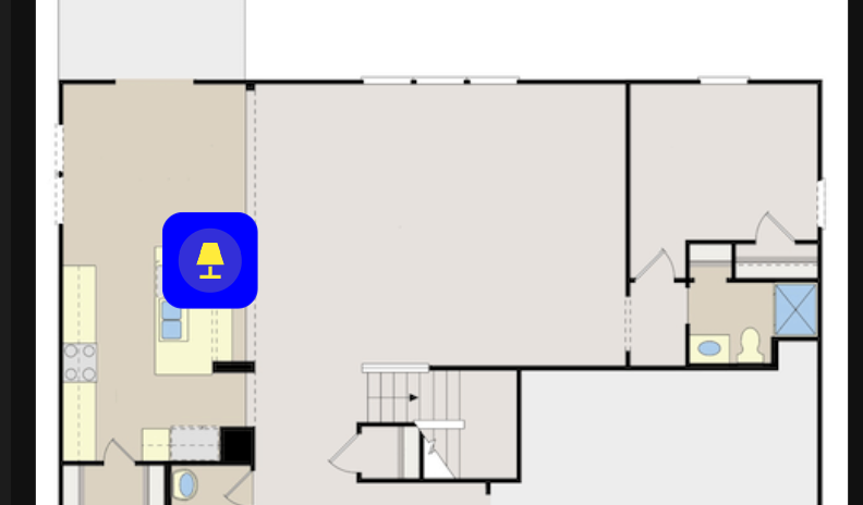

I’ve been trying to style a conditional element using card-mod. I have a “picture-elements” card with loads of labels and icons inside, even a couple of conditional cards. I want the background of one of those conditional cards to be red (in my example) but everything I try doesn’t seem to work.
This is the specific piece of code I want the background to be red. Does anyone know why this isn’t working?
Does it work without the conditions?
type: picture-elements
elements:
icon: mdi:lamp
icon_color: yellow
style:
top: 200px
left: 100px
card_mod:
style: |
ha-card {
background: blue;
image: https://demo.home-assistant.io/stub_config/floorplan.png

Yes, without works fine. I have card_mod in multiple places working just fine.
Probably best you share the entire card code. There has to be a card_mod conflict.

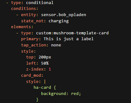

This is the entire code, from row 200 is the “problem” part.

- type: conditional
conditions:
- entity: sensor.bob_opladen
state_not: charging
elements:
primary: This is just a label
tap_action: none
style:
top: "-200px"
left: 50%
z-index: 1
card_mod:
style: |
ha-card {
background: red;

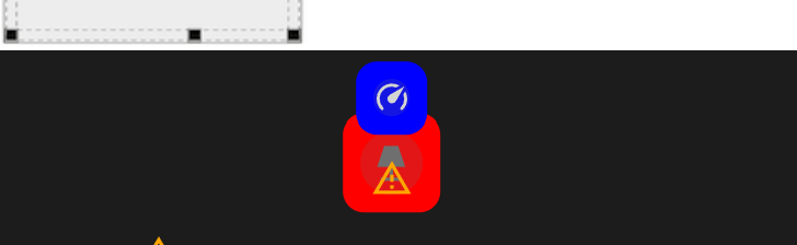

Suggest you to always post a simplified minimal code. I do not think that anyone would count number of lines using a browser.
A lot going here beyond your original inquiry, but I was able to change the background colors.
elements:

- type: conditional
conditions:
state_not: charging
elements:
tap_action: none
style:
top: "-200px"
left: 50%
z-index: 1
card_mod:
style: |
ha-card {
background: red;

icon: mdi:lamp

scheper
(Roel)
June 27, 2025, 2:18pm
8
I’m afraid you changed a part that was working. It’s the part where “primary: This is just a label” is.

I ran into this issue the other day where card-mod does not work in conditional elements. After fighting it for several hours, I found an old issue that describes this behavior so I think it is just a limitation of card-mod or a peculiarity of how the conditional element works.
Anyway, I found a suitable workaround, at least for my situation. Instead of the conditional element, I just use the regular element (in my case a state-label) and then in the card-mod style use a template to inject css variable “display: none;”
I have no idea what I am doing, but this seems to get the job done.
