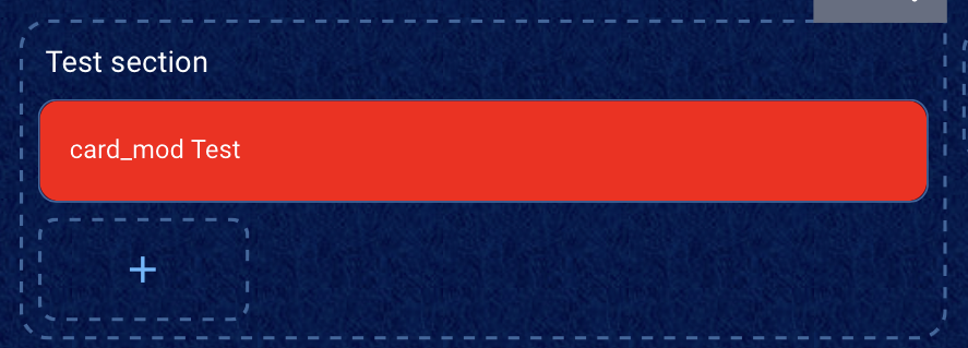

Your config works for me:
Likely you have an indentation issue but I can’t see that because you did not format your post correctly for the forum
type: markdown
content: card_mod Test
card_mod:
style: |
ha-card {
background: red !important;

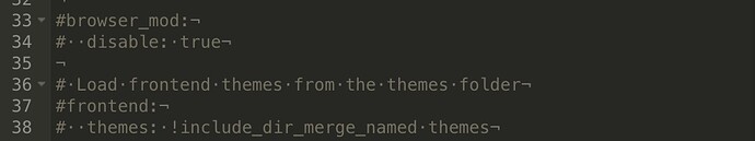

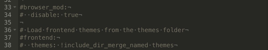

I got it running…
I‘ve checked my configuration.yaml and together with Claude I found 2 entries that might be the cause of my problem…
I think these could be part of an old integration that I’m no longer using for a long time.
After removing card-mod is working as expected.
