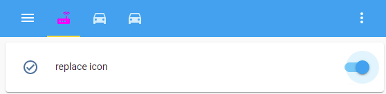

3. Replaced icon: (Chrome only)
  card-mod-root-yaml: |
    paper-tab[aria-label='test_tab_1'] ha-icon $ ha-svg-icon $: |
      path {
        {% if is_state('input_boolean.test_card_mod_themes_header_change_tabs','on') %}
        d: path("M 20.2 5.9 L 21 5.1 C 19.6 3.7 17.8 3 16 3 C 14.2 3 12.4 3.7 11 5.1 L 11.8 5.9 C 13 4.8 14.5 4.2 16 4.2 C 17.5 4.2 19 4.8 20.2 5.9 M 19.3 6.7 C 18.4 5.8 17.2 5.3 16 5.3 C 14.8 5.3 13.6 5.8 12.7 6.7 L 13.5 7.5 C 14.2 6.8 15.1 6.5 16 6.5 C 16.9 6.5 17.8 6.8 18.5 7.5 L 19.3 6.7 M 19 13 H 17 V 9 H 15 V 13 H 5 A 2 2 0 0 0 3 15 V 19 A 2 2 0 0 0 5 21 H 19 A 2 2 0 0 0 21 19 V 15 A 2 2 0 0 0 19 13 M 8 18 H 6 V 16 H 8 V 18 M 11.5 18 H 9.5 V 16 H 11.5 V 18 M 15 18 H 13 V 16 H 15 V 18 Z") !important;
        color: magenta !important;
        {% else %}
        d: path("M 12 2 A 10 10 0 0 0 2 12 A 10 10 0 0 0 12 22 A 10 10 0 0 0 22 12 A 10 10 0 0 0 12 2 M 16.2 16.2 L 11 13 V 7 H 12.5 V 12.2 L 17 14.9 L 16.2 16.2 Z") !important;
        color: cyan !important;
        {% endif %}
