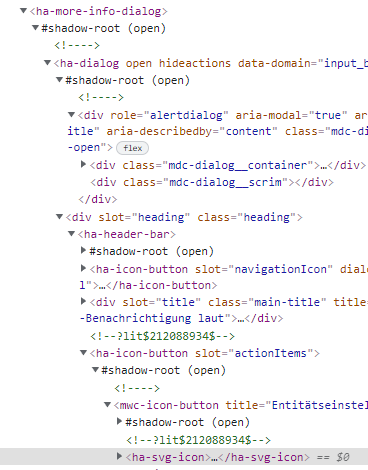

can we hide the cogwheel on the more-info-dialog cards Entity settings? Id like to prevent that other than administrators can edit the entities…:
I do already have several more-info options in place under card-mod-more-info-yaml: | in my card-mod-theme, but cant find the correct selector here…
(“ha-more-info-dialog”).shadowRoot.querySelector(“ha-dialog > div.heading > ha-header-bar > ha-icon-button:nth-child(3)”).shadowRoot.querySelector(“mwc-icon-button”).shadowRoot.querySelector(“button”)
      ha-icon-button {
        display: none;
I would still propose, forget about all this and try to see this in the tree. For me it’s much easier, esp. if you see then possible improvements there (e.g. point 3 below).
Example.
  1. Selected the icon in UI, which results in selecting the ha-svg-icon.
  2. Only hiding this? Why, if mwc-icon-button is only one layer around and both are in ha-icon-button.
  3. Decision: Hide ha-icon-button
  4. Is it inside any shadow root above on the way to the top parent ha-more-info-dialog, where we put in our card-mod?
  5. Checked: No. Not at all. It is directly selectable in ha-more-info-dialog, that means .: |
  6. Done
thanks! very nice.
Ive added:
        ha-icon-button {
          display: {{'none' if is_state('input_boolean.hide_more_info_settings','on')}};
        } /* hide more info settings cogwheel */
it does also hide the closing X, but we can simply click next to the panel to do that too…
Same tree example. If you see such things, you directly see, that there is a slot attribute, different in both ha-icon-buttons, so you can e.g. narrow down to
  ha-icon-button[slot="actionItems"] {
    display: none;
in this case.
Even better , because on mobile, we do need the X :wink:

            mwc-icon-button:
                .mdc-icon-button {
and that didnt help ;-0
so, Ill await your findings with some healthy impatience :wink:
