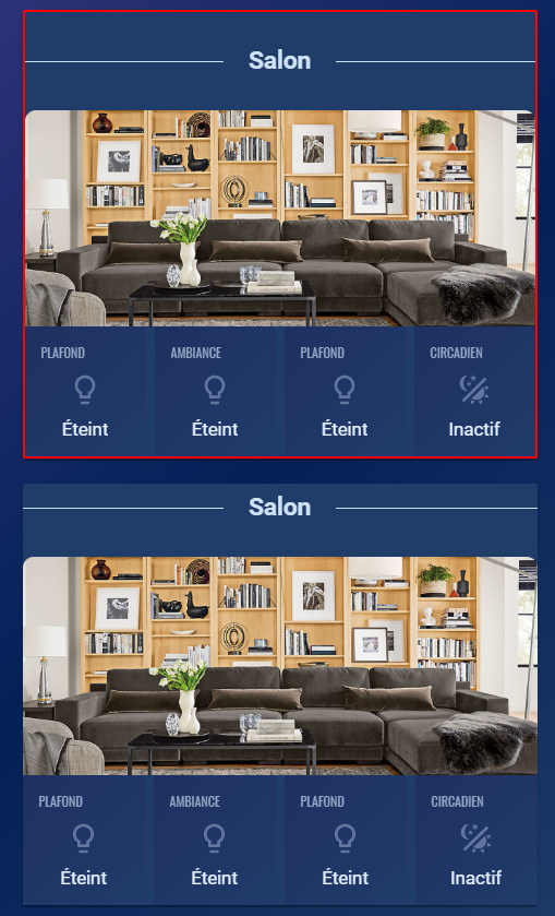

Card background dissappears and there are just snippets of border at the top and bottom:
capstan1
(Capstan)
May 12, 2019, 6:01am
5
Looks greats, though!
I know, what you got is not intended, but you mind sharing your theme?

Thanks for your help. I think I’ve found something. It’s been a long time since I’ve dug into css so I can’t explain why, but display: block; is a potential solution.
It’s not pretty but hey, whatever works. Following example on the (messy) UI I’m working on:
Thos are two vertical-stacks-in-card , both in card-modders . First one has a 2px solid red border.
Relevant yaml:
- type: custom:card-modder
style:
margin: 10px
display: block
border: 2px solid red
card:
type: custom:vertical-stack-in-card
cards:
- type: 'custom:card-modder'
card:
type: 'custom:text-divider-row'
text: Salon
style:
font-size: 15px
--secondary-text-color: '#CEE2F7'
Hope this will help someone !
*ps: if anyone can help me getting rid of the margins in my horizontal stacks that’d be sweet *

You mean the yaml i posted ? I did not realized it wasn’t formatted properly, I’ll fix that.
Otherwise, I finally managed to get rid of the margins that bothered me ! I’m getting close to something I like now:
Obviously there’s still a lot of work, and I want to make clear that the design’s not mine , I just found a nice picture on google images and tried to replicate it.
