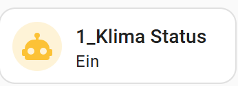

but how can I show “triggered by state of” in an entity card?
Can the name of the triggered entiity shown as name in the entity card?
my wish is that “1_Klima Satus” replaced by the last triggered entity in the helper “Climate Control Delonghi IR On 21°C Klima Full” shows up in the entity card

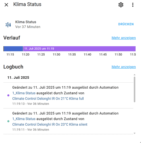

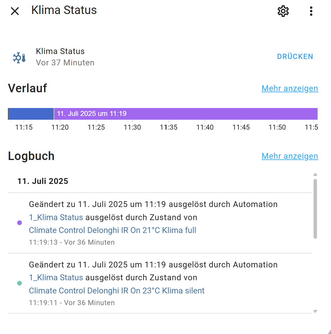

Found a Solution,
Create an automation, and in actions use persistent_notification.create
I now see the Status of the climate, in an entity card, the state change when the button in HomeAssistant ist pressed or when the IR Remote Control sets the temp in the climate

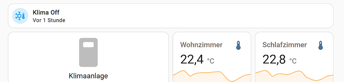

  - action: input_text.set_value
    metadata: {}
      value: "{{ trigger.to_state.attributes.friendly_name}} "
      entity_id: input_text.klima_text
mode: single

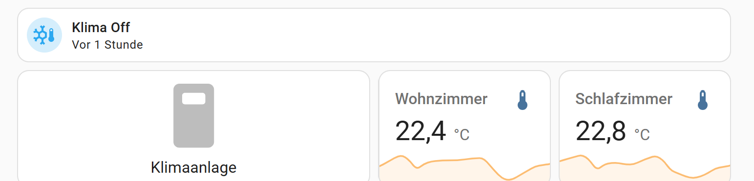

Dashboard, Mushroom Entitity Card
type: custom:mushroom-entity-card
entity: input_text.klima_text
layout: horizontal
fill_container: true
grid_options:
  columns: 24
  rows: 1
icon_color: primary
icon: mdi:snowflake-thermometer
primary_info: state
secondary_info: last-changed
