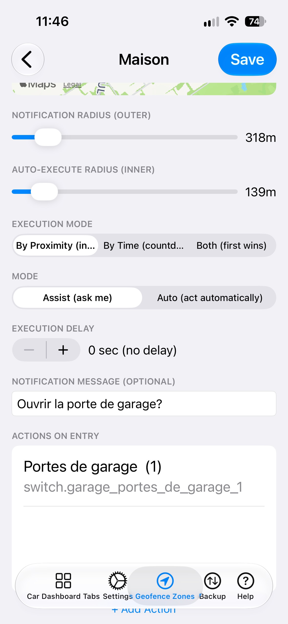

Hello Lucian,
Just installed v2.0. It gets better every time!
Location permission now shows Always, which I selected.
The geofence option does work, but with some problems.
The HA action was triggered automatically when I entered my Home zone, although my mode was Assist.
The notification message never appeared on my Carplay screen, but I noticed when I came home that it had appeared on my phone. CarHA did not wait for my reply and triggered the action.
This is my setup:
Any suggestions?
Denis
Hi Denis,
Thanks for the detailed report — that’s exactly the kind of feedback that helps.
You found a real bug: in Assist mode the inner geofence radius was still triggering the action automatically, instead of waiting for your confirmation. That’s now fixed — Assist mode always asks before running anything.
I’ve also fixed CarPlay notifications: the geofence prompt wasn’t allowed to show on the car screen. It now can (make sure notifications for CarHA are enabled in CarPlay, Settings).
Both fixes, plus a couple of other improvements, are in version 2.1, which I just submitted for review. Once Apple approves it you’ll get it as an update.
