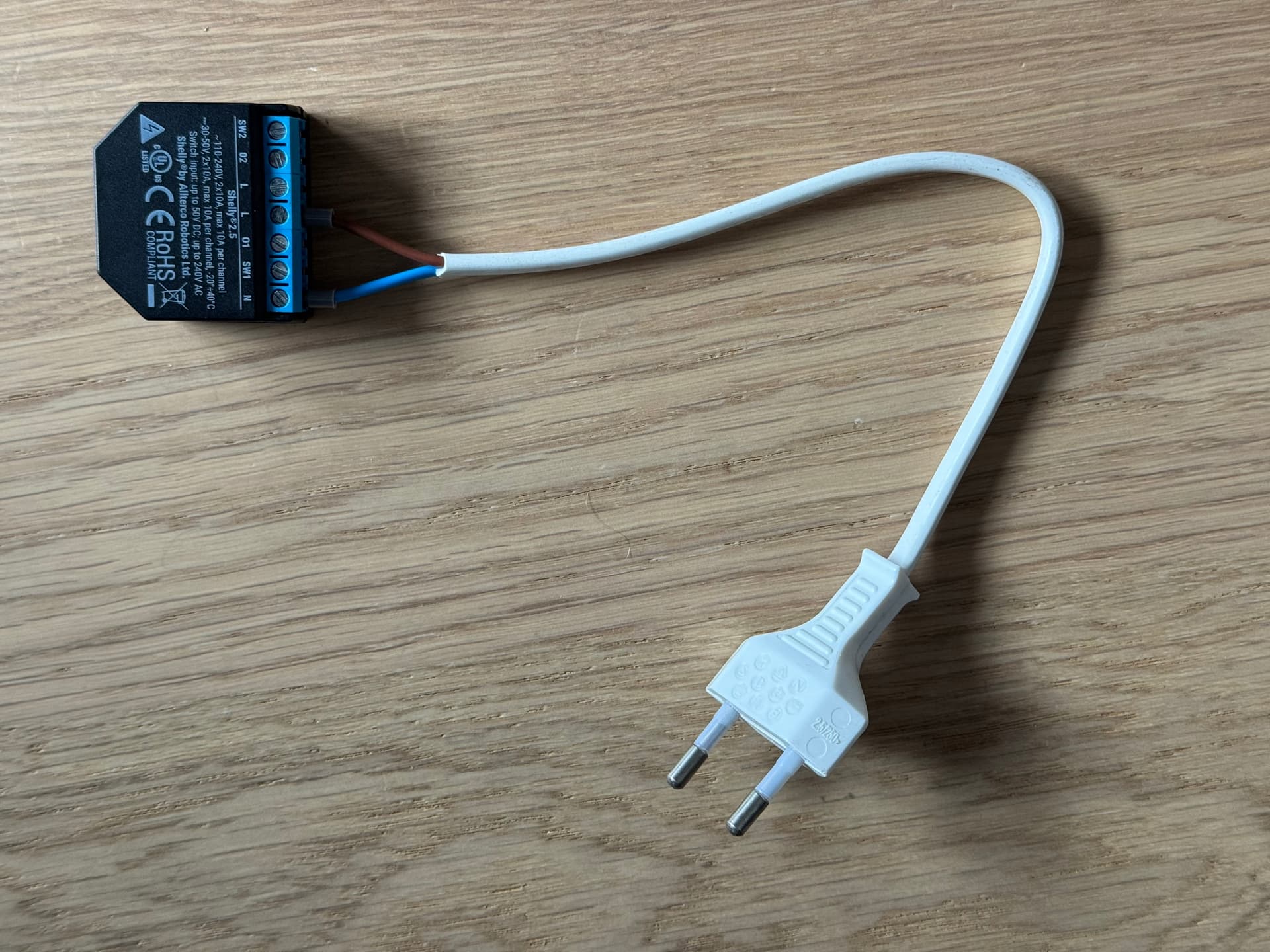

I found that Shelly Cloud is free and CarPlay-enabled :blush:. Here’s what I did: I used a Shelly 2.5 (or any device with two relays) and integrated it into Home Assistant. It doesn’t need to be wired to anything—it acts solely as a broker for the free Shelly Cloud.

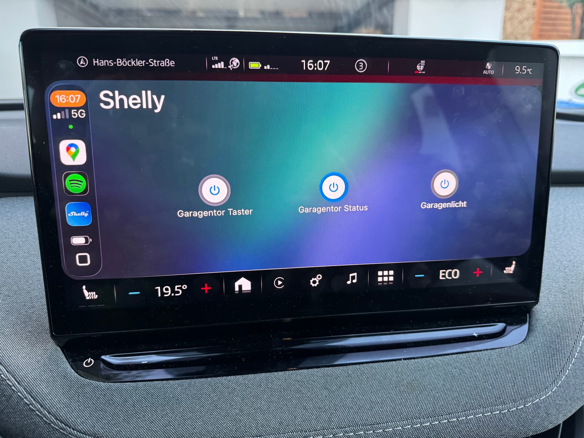

The first relay is for the opening/closing the door as a button to be tapped in carplay, the second relay is an indicator weather the garage door is opened or closed.
I created two automations:
  1. Garage Door Toggle: This automation toggles the garage door using the cover service when pressed. It also updates the second relay according to the door state. Simple as that—I now have a button to open or close the door and an indicator showing the current door status in CarPlay.
  2. Relay Status Correction: This automation handles the second relay, correcting the status if it’s accidentally switched manually.
