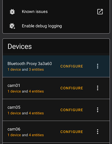

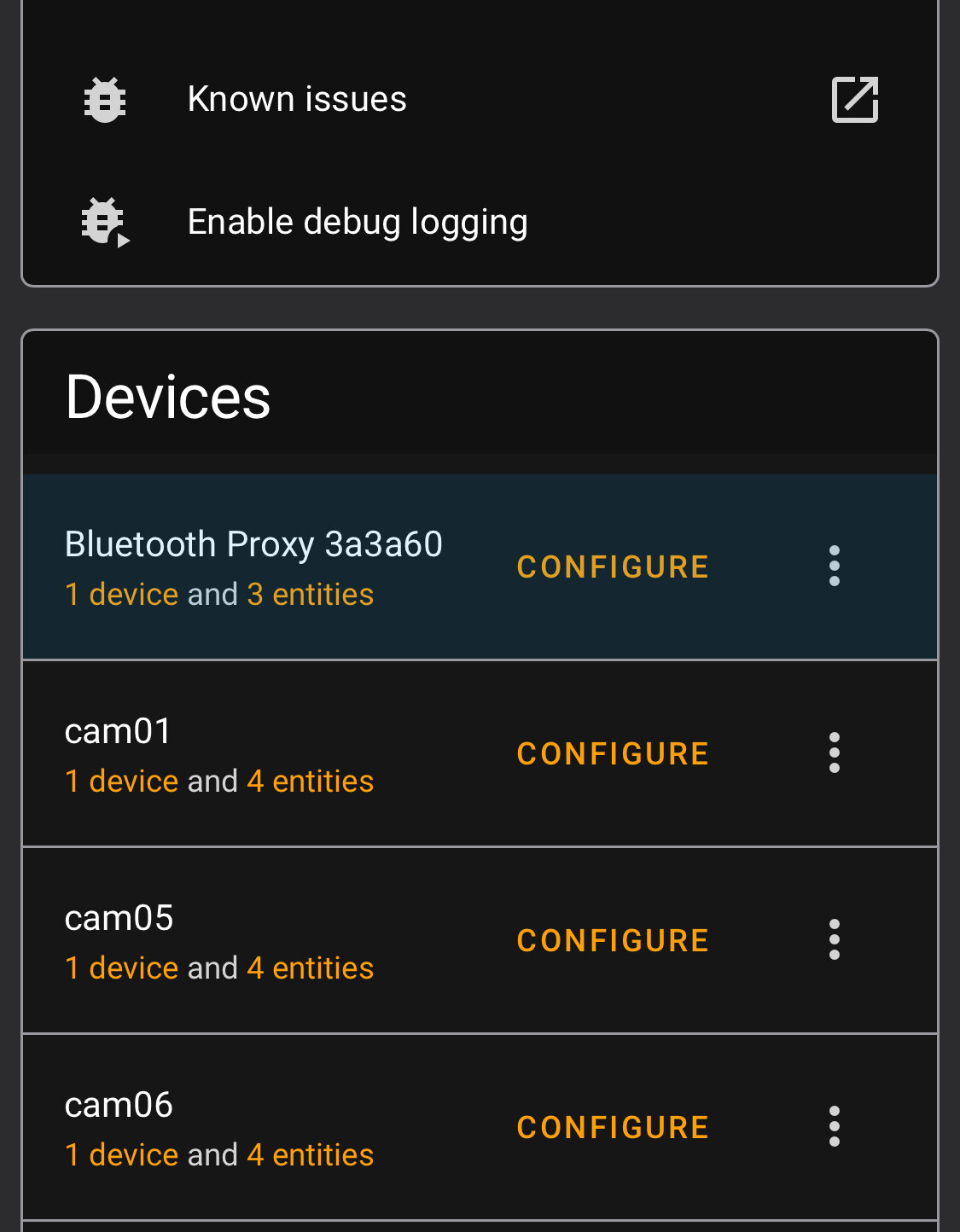

Maybe I am looking at the wrong place. The adapter seems to work fine.
Why is it in blue? Does that mean anything ?
Any further advice since you got it working…?

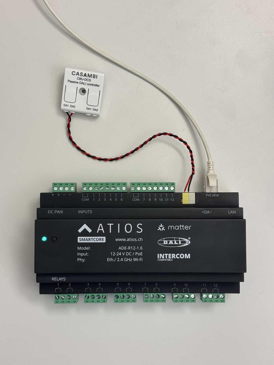

Two options, that are a bit more expensive but work reliable:
  1. Atios SmartCore + Casambi CBU-DCS: basically the CBU-DCS makes Casambi lights available via DALI, and Atios SmartCore then controls them via Matter, meaning easy integration in HA.
  2. We do not have a timeline yet, but at some point Atios LumaPort for a direct integration of Casambi Lights into Matter / HA will be available.
See also this HA forum thread here…
