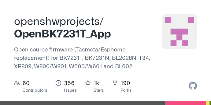

I know you have already found a solution, however in case you @InToSSH have another need or some else @Kaizen28 does. I have successfully been using several of the TUYA MCU based lights for almost two years now with 100% local WiFi control via the Open Beken project. You can now install espHome firmware on these as well. While I have not added a light sensor to this particular Tuya device, I have hardware ‘augmented’ other devices where I have replaced the firmware with Open Beken. The specific Taloya device I have worked with is 120 volt USA power, however I am pretty sure they sell the same device with 220 volt RoW support.

Thank you for a great tutorial. This light looks really nice, I like the RGB ambient feature which would replace the night light mode I have in my light. Too bad it also doesn’t have a PIR sensor, but I guess I could always place an external zigbee PIR in the room. Also thanks for the Open Beken project, I didn’t know about this project and I have a few Tuya devices with those new chips.
