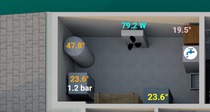

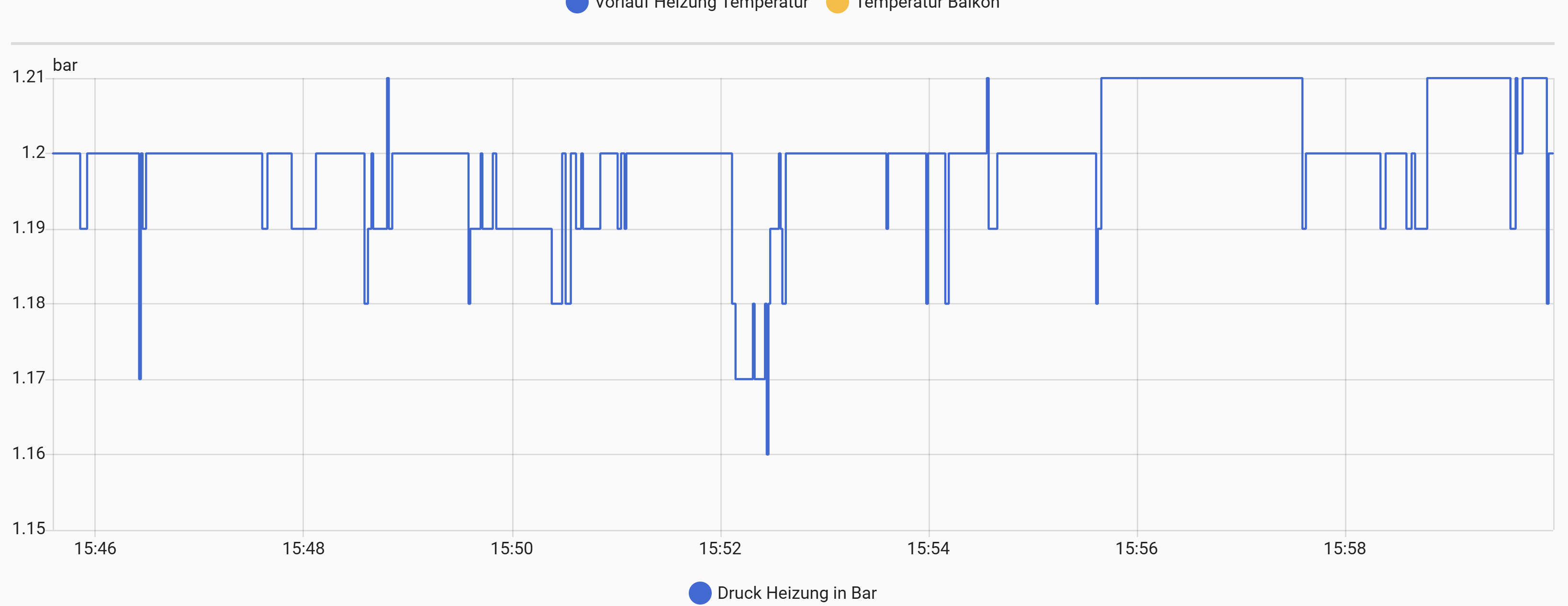

Old thread, but I wanted to monitor my heating system pressure in HA and finally got around doing it.
It basically consists of
The analog in of the Shelly Plus Uni takes the sensor voltage and will give you a voltage between 0.5V and 4.5V depending on the pressure of the system - turned that into a template sensor - very pleased with the outcome:
