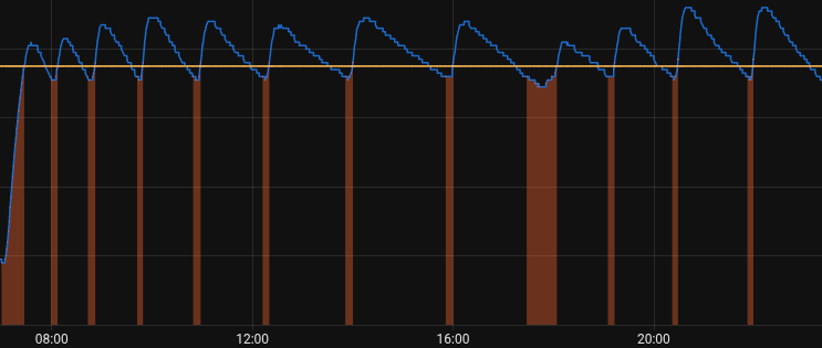

in my home-office there are 2 radiators, and each time they are activated (because the temp goes under the threshold value) the temp in the room overshoots massively because the radiators keep giving heat well after the system shuts the solenoids off (because it’s warm enough).

This could be your solution, if you understand of are ready to learn about PID.
GitHub - ScratMan/HASmartThermostat: Smart Thermostat with PID controller for HomeAssistant
This may work
Use only one radiator to controle the temperature and the other one as backup like
Example
Rad1 open at 19 and close at 20 degrees
Rad2 open at 18,5 and close at 19,5
And if rad 1 is open for x minutes and temp is still below x then open rad2 also
