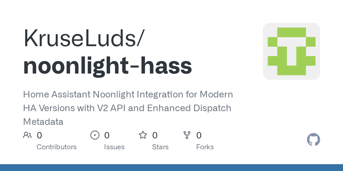

May 10, 2026 Update: Before I could finish my setup I discovered the HA Noonlight integration was using an old version of their API which had very limited functionality. So I forked it and created "Noonlight Enhanced" based on their newer API - and this newer integration has all the functionality needed to complete the below work - hot off the presses! Enjoy!

Actually the integration needed considerable improvement, so I dove in!
Hot off the presses - Noonlight Enhanced! My unofficial Home Assistant custom integration for the Noonlight Dispatch API... based on the original Noonlight Home Assistant integration project and has been significantly extended to support modern Noonlight Dispatch API workflows, sandbox testing, Home Assistant event generation, webhook integrations, richer dispatch context, improved diagnostics, and advanced Home Assistant automation architectures.
