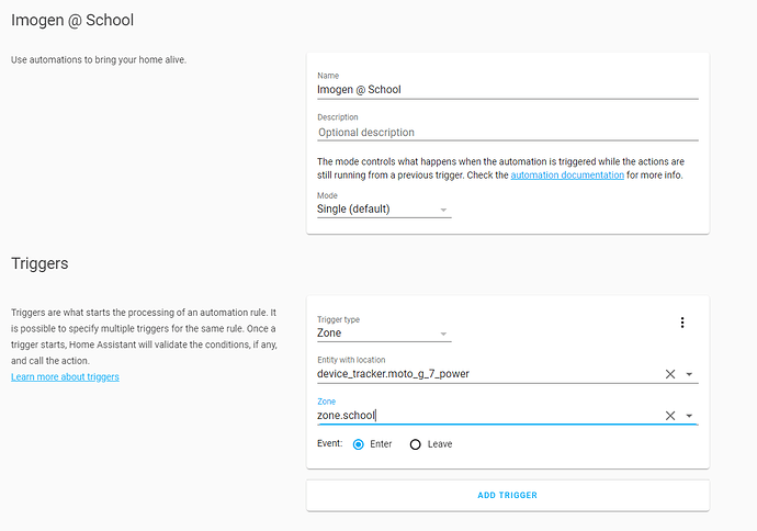

I am using the automation gui accessed through the Configuration menu.
The screen shot is what I have.

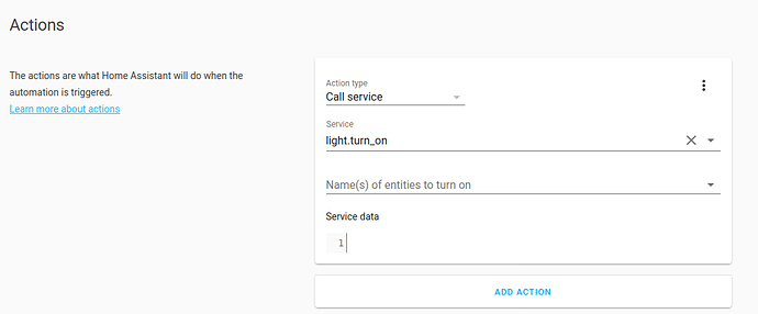

Lower down on that screen when I want to create the action, I only get a list of devices to action. However, Office_Lights is an entity therefore is not shown. I would like to toggle them 4 times (so they cycle back to the same state as previous) with a short delay between each - maybe 5 seconds. Does this have to be done in the yaml and not the GUI ?
  1. Change “Action type” from “Device” to “Call service”.
  2. Set “Service” to “light.turn_on”.
  3. Enter the name of the light entity you want to turn on.
Sheesh! Devices have made automations so much easier :roll_eyes:
Brilliant - thanks!
