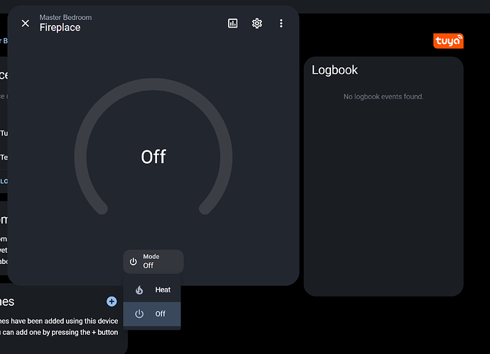

Good day smart community. I tried to change Tuya smart fireplace mode ( off/ heat) to simple on/off switch using template, but no luck.

Fixed by myself, using OpenAI help
