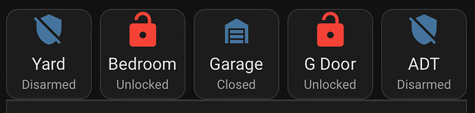

Locks & Alarm are green when in locked / armed mode while garage is blue in closed mode. Also alarm is blue in disarmed mode. This creates confusion while doing a quick view on a phone screen. How do I change garage to green in closed mode.

i don’t believe you can do this with the standard button cards that you are using (someone else may correct me, but i don’t know how).
however you should be able to do it using the custom button card. take a look here… here’s a link to the specific section that tells you how to do just what you’re asking:

@armedad Here is how you can change the color on the standard button card. I don’t have a garage door cover but this should work for @HAUZER
show_name: true
show_icon: true
type: button
tap_action:
  action: toggle
entity: cover.bed_curtains
show_state: true
card_mod:
  style: |
    ha-state-icon{
    {% if is_state(config.entity,'open') %}
     --state-color: red !important
    {%else%}
     --state-color:green !important
    {%endif%}
