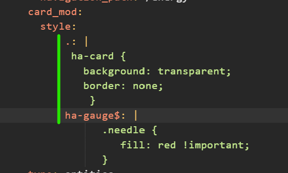

Hi
I have try your code and it dosen´t work for me.
Can you help me to past the code in the right position?
Thanks

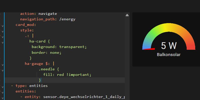

Indent this part.
As @Ildar_Gabdullin pointed out the ha-gauge $: | has to align with .: |
Thanks, it works fine.
